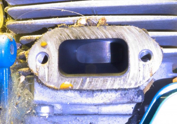

    That's where I'm at right now. The muffler screws were packed with dried mud for some reason so I couldn't get them out yesterday, but I propped the saw upright and filled the tubes with water to soften things up overnight, got the dirt out of the way and pulled the muffler a few minutes ago. Not straight gassed...
    So, either there's a foreign object wedged under the flywheel, or the crank is busted. At the moment I don't know what to think, except that a broken crank would be really freakish because everything else says this saw has hardly been used at all. I haven't found a scratch on it anywhere.

    I'd be removing get that recoil cover.
    Coil came loose? Magnetize and won't turn?
