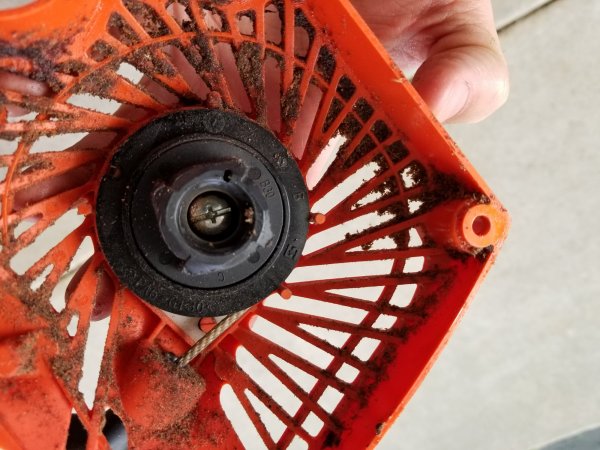

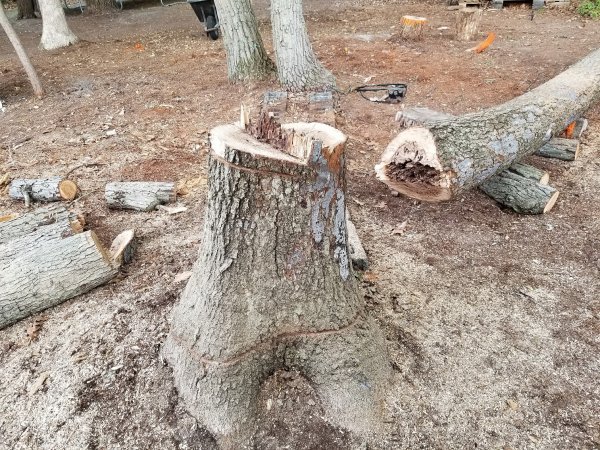

    LN I was going to town on a stump from a dead tree I felled a few days ago, probably little too big for my saw but I went at it pretty good (see pic). It was only about 15" at the top but at the base is was approx 20". I got about 3/4 of the way and the saw was just smoking literally and was so hot. Wasn't able to restart it. Felt like the starter rope was skipping couldn't grip to turn the engine over. Took apart and looks like it's worn a bit (see pic). So ever since been thinking of an upgrade and going with a Stihl or a Husqvarna. Thinking back the past 2yrs I have used this saw a lot to drop many many trees and ones I had pro's drop I chopped up myself.
    Now oddly enough this morning after letting it cool all night when I tried to start it, it still did skip but no where near as bad as LN and I did get it cranked over. So I was looking for recommendations, I am not a pro but use it enough but don't need a monster. Was looking at the farm boss 50cc but that looks like a monster maybe little too heavy too much for my needs. Thanks in advance!!

    One thing to consider is what happened to your saw. Flush cutting stumps puts the exhaust discharge in the corner of the stump and the dirt, leaving the heat nowhere to go except back into the saws intake and cooling air. The heat from the exhaust starts cooking the saw and can permanently damage it if you’re not carefull.
    That sounds like what happened with your saw.
    It’s best for the saw to keep a few inches between the ground and the exhaust discharge, giving the heat room to escape
    Also, root blooms typically have sand, rocks, and dirt embedded into the wood and bark. This is where semi-chisel shines. Full chisel will dull real fast, adding the additional saw killing ingredient of high rpm’s screaming without cutting ...........
    The stump can kill a saw faster than most realize, no matter what saw you choose

    No offense to anybody, but I see very little reason to recommend the stihl ms250 over an echo cs490, and I like Stihl saws as much as anyone. One is a pro quality saw the other is a homeowner saw.
    Beyond the saw issue you have been having, let's talk about the tree you cut down. It's hard to tell from the pic, but it looks like the face cut on that stump is dodgy.
    There are some parts of this video I don't necessarily agree with, but it's a good place for you to start.
