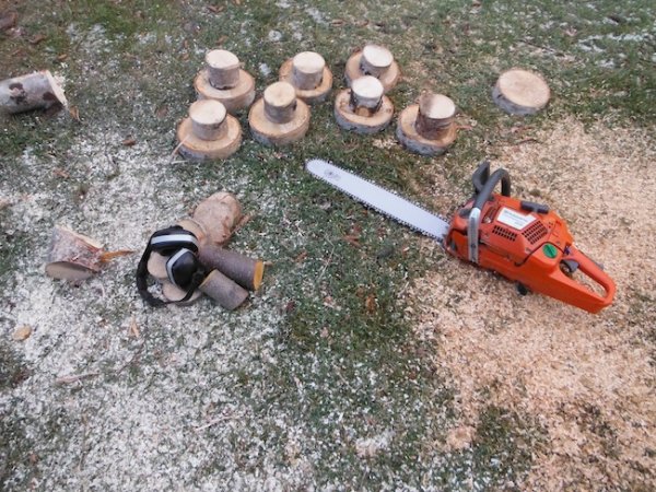

    I had to touch it up a few times but good clean wood & mossy, lichen ground
    The chain held up well.
    Then I go to cut a few hats for snowmen & I bump a rock in the grass
    Not once but TWICE
    Last cut was throwing dust & the saw was screaming at me.
    I'll sharpen it up but it PIZZZD me off.
    All that cutting & at home doing just a few cuts I'll have to really sharpen
    it now.
    More filing than I did for 6+ cords
    :picard:

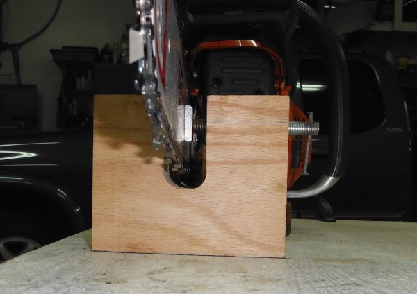

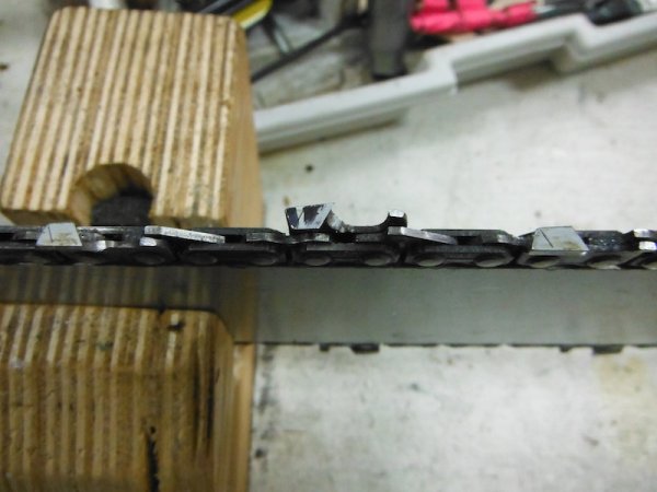

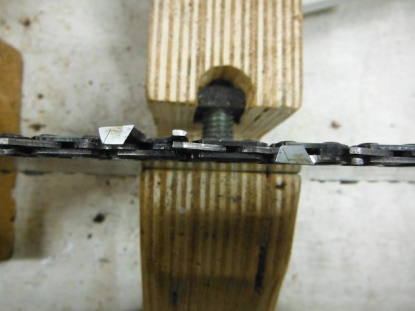

  16. bogydave
    Cleaned & sharpened
    took the rakers down a tad
  17. Jon1270
    Jon1270
    1,886
    4,543
    Pittsburgh, PA

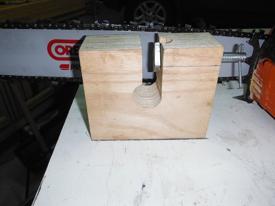

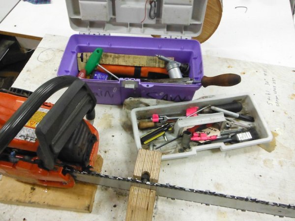

  18. bogydave
    Thanks
    Made it years ago
  19. clemsonfor
    clemsonfor
    15,996
    37,474
    Greenwood county SC
    Is that like 1.5" plywood it's made of?
  20. bogydave
    3 pieces of 3/4" glued together
    2-1/4"
    Screwed to a piece of 3/4" (roughly a 3' square) plywood that I clamp to a work bench top
    ThinkI used a 5/8 " bolt/all-thread , drilled & tapped the end & put a piece of aluminum on the end for the threaded jaw
    I glued in a nut but threading a bolt thru the wood,drill the hole a size small, would work.
