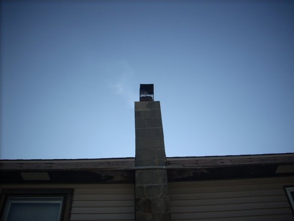

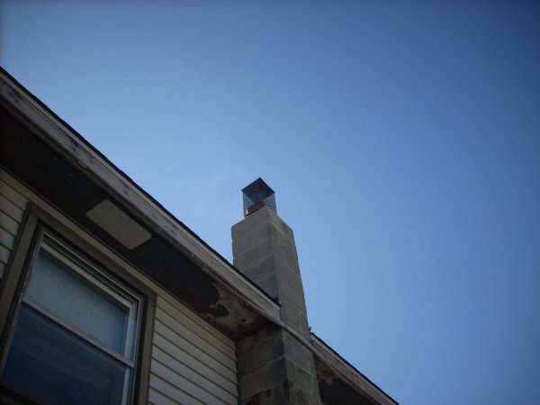

    Shack If you can get ya some stainless or mild steel expanded metal and wrap it around the cap and have someone "tack" weld it on the cap. No birds, "ever" will not clog unless your burning some nasty wet pine. Or gut the cap and put in wider screen. Here is a pic of mine when I first made it, Been there now 27 years so far. Yes my facia was getting replaced that year, looked like crap... :whistle: DSCN1587.JPG DSCN1588.JPG
