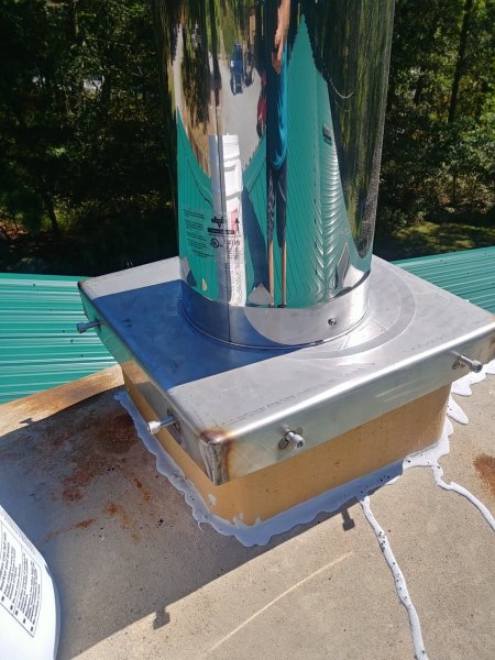

    Added 3 ft. of Class A pipe today..
    My transition plate was put into a break n all 4 sides were bent 90* s.....drilled 2 holes on each side....welded stainless nuts into place with stainless cap bolts.
    Ran a thick bead of high temp locktite adhesive around the top of the terracotta flue n transition plate....
    Think it'll hold ??

    That’s lookin’ good!!

    Very clean install.
    :yes:
    Like that spark arrestor, very nice.

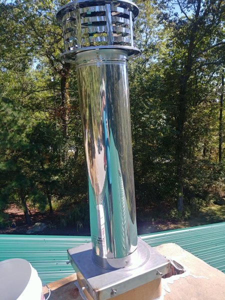

    That spark arrester looks like something out of Mad Max. :dex:
    I'd lose it, and get a more open design. JMHO Sure is shiny.

    papadave is correct, you should get a more open design one and send that one to me for disposal purposes.

    I think that spark arrester will work out okay.
    btw bear 1998 if it don't work, you'll always know that it should have. Did the wife help?

    Install looks good. My spark arrestor looks very similar, except mine has screening inside of the slots too.
    That crown sealer works great, and looks great too. I sealed mine last fall.

    Great looking install! That new SS looks so pretty, make sure you give it a buffing when your up there for your flu cleanings.
