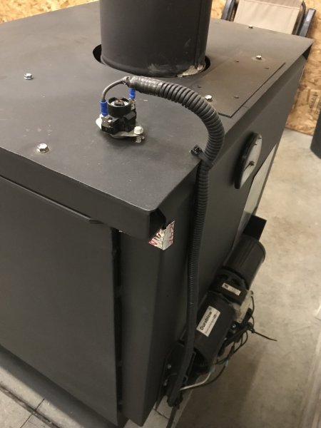

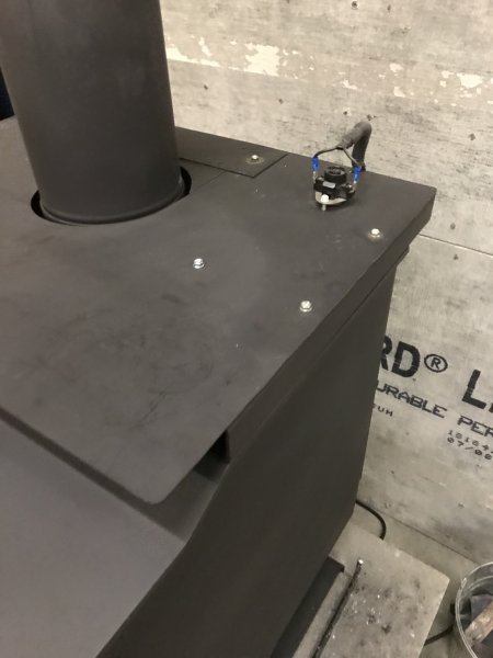

  11. blacksmithden
    blacksmithden
    Aug 14, 2017
    362
    2,710
    Alberta Canada
    Do you mind if I ask where you mounted it Highbeam ? I bought one of the non adjustable ones and finally got around to putting it on this year. I'm afraid to put it right on the side of the stove for fear of killing the magnet if it gets too hot. I put it high up on the back shield, but it takes a long time to cut in the fan with it there.
    Horkn, brenndatomu and Eric VW like this.
  12. Highbeam
    Highbeam
    Jun 25, 2014
    1,887
    6,030
    Set at 105 on top of the convection deck.
