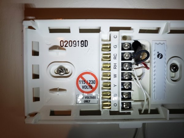

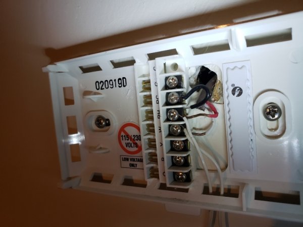

    Anyone had a ThermGuard quit working? I don't get any blinking lights at all when I turn it on. It "seems" as if it is still hooked to the thermostat properly, but I will have to look into it once it warms up just to make sure. I just had a new boiler installed - but it is using the existing 2-wire connection on the thermostat, so nothing was disturbed on that end.
    Hmm, now that I think about it, I believe the old boiler on the heat setting (as my pellet stoves do), and for whatever reason the new boiler had to be set in the "auto" to start a cycle. I wonder if that has to do with it being a multi unit (does DHW also), or a condensing unit. But at the same time, I wouldn't think that it would matter to the Thermguard.

    Hope you get it sorted. Doesn't sound like the TG is at fault. May just need to play with the control wiring to cycle the boiler. If I get a minute today I'll download the TG manual and check the wiring diagram. What boiler do you have?

    Thank you, I appreciate any insight you can give me. I just don't understand why it gives me no blinking lights when I turn it on. If it did that, but didn't turn on the boiler, I would be 100% sure that it's not the TG's fault.
    The boiler is an HTP ELU 120 WCN. Using a LUX DMH110 thermostat (which is also what I use for the pellet stoves)

    Looks like one of the TG wires(I'm assuming they are the 2 white wires) needs to go to the G connection at the top. One stays on the RH terminal. And the other from the W terminal should be moved to the G terminal.

    I thought the G was for FHA, not gas boilers, but I tried it anyway. I changed the W to the G and still get no lights to flash when I turn the TG on. I switched it back to W, made sure the RH was installed well, and no blinking lights. I'm thinking that the TG just decided it didn't want to play any more.
