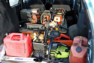

    I did 24:1 with juice. I think my 1 gal cocktail mix can is still marked that way. Then when I went alky/nitro it became my flush can.
    DexterDay, Hedgerow and mdavlee like this.
  14. Cut4fun
    Cut4fun
    Mar 18, 2014
    1,941
    3,571
    OHIO Redneck
    Pic of can with 24 on it.

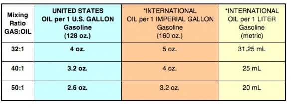

  16. bogydave
    My mix is always a little heavy on the oil side.
    I figure I don't get 100% of the oil out of the little bottles so I only add .9 gallons of gasoline.
    Don't know what mix ratio that is, but never saw a 2 cycle engine burn up with to much oil in the gasoline,
    but to little oil can cause expensive bad things.
    IMO some where between 50:1 & 40:1 is good
    .5 oz more in a ( 128 oz) gallon is not earth-shattering, but erring on the safe side makes me fell better.
