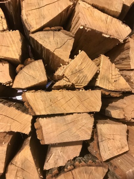

    These piles of Red Oak in my basement were cut, split and piled into the woodshed in Sept of 2017. One year later they were stacked in the basement in late Aug. of 2018.
    Once in there, I put the dehumidifier on beside the stacks for a few weeks until the burning season started.
    Once the burning starts the humidity inside drops pretty quickly. The inside humidity right now is 24%.
    So today I picked the biggest split I could find off the top of the pile. It was about 6" from point to point on the bark edge. It was a solid piece with full bark and no rot at all. Took it outside and split it right down the middle.
    It was at 16% on the MM on the inside of both splits.
    I do have creosote problems when I first start burning in the Fall because the moisture content is too high at that point, but once the furnace is running steady from about mid Nov. on, it sucks the moisture right out of the wood. I have no creosote now after cleaning the chimney in Nov. and still won't at the end of the heating season this Spring.
    The point I'm trying to make is that I've gotten the moisture content down to a perfectly acceptable level using the dehumidifier and the heated basement in a little over a year. One year outside in a covered woodshed and four months inside with heat and low inside humidity. With Red Oak.
    This is the first time I've actually taken a reading from the wood inside mid way through the heating season but I've been expecting a similar reading because in my experience over the years of doing this I have a creosote problem early on but it goes away quickly and doesn't come back, even with the Springtime smoldering fires.
    I don't mind having to do the chimney once or twice at the beginning of the heating season if I know I'll be good for the rest of the year.
    Just letting everyone know how my one year plan is working and why.

    That stack is a work of art Chris.:salute: :coldone:
