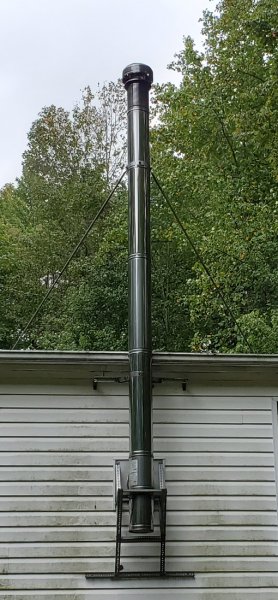

    Someone asked about the chimney the other day. The answer is no. It has been in my mind but no action. I did ask the manufacture of the stove how they measured height of the chimney in their manual and I was told from the floor to the top of the chimney. If that is the case, then the chimney meets the requirement listed in the manual However, others have said the chimney is too short. I have also been told that large door stoves are going to leak; that such a large opening kills the draft and that is just a matter of fact. I hate to go to the trouble and expense only to find that the stove still spills smoke when refuelling. The draft isn't an issue during the burn; it is the smoke spillage when refuelling.
    The chimney is 12 feet from the top of the tee; the reason for the two short pieces at the top was I was scrounging for chimney sections at the time I built the chimney to save money.
    I live in an older doublewide manufactured home. The stove is in a room with a vaulted ceiling with no real space in attic to hang a ceiling box; so even if I had located the stove against an inside wall, I don't think I could have properly supported the chimney. Therefore, I located the stove on the outside wall and used a through-the-wall kit. However, I am told that this reduced the draft of the chimney. I cannot reach the top of the chimney from the roof. However, I did check and there is a rental company with a scissors lift that will reach the top of the chimney; cost of the rental is $150.00/day. I might have to use the Old Girl to get the scissors lift in the back garden. I didn't plan well on having access to the back garden with machinery. I can get the chimney (three foot section) from Lowe's; cost $104.00 I am sure my BIL would haul the scissors lift to my house. I would probably install a second roof guy; Menards at $62.00 (shipping and taxes). Therefore, the job can be done for a cost of around $316.00 plus some taxes. Not that bad if it solved the problem; if I did spend that money and it still spilled smoke into the house, I wouldn't be a happy camper at all. Now to the other solution mentioned.

    Maybe call a tree guy that has a bucket truck and see if he’ll slip the extra section on for $100 or so.

    No way to drive a bucket truck in the back garden; I can just barely get the 8N in the back garden. Poor planning on my part. No way to get it in the front garden either, I put flower beds with stone borders covering most of the front garden. I might search and see if there are any chimney installers in the area. Thanks.

    I don't recall, did you change your 90's to 45's between the stove and the chimney? If not, that would be my first step...

    Oh for crying out loud. The chimney is made of mainly three foot sections. Disassemble at a point you CAN reach, lower that section, add your additional section on top and lift it back into place and re-connect.
    Play with some legos for practice if needed.
    It's not rocket science.
    You don't even need an engineering degree.

    Spilling smoke is most often from a chimney that has not responded to a sudden change in input. The smoke (or heated air) is just taking the path of least resistance. Usually just cracking the door -just enough to initiate a rate of change- is enough to start getting the flow changing to a more rapid rate in the chimney. How long you have to wait to further open the door depends on local conditions and your setup. Sometimes opening the draft fully first before cracking the door helps . It can often mean a bit of finesse with one's technique and some patience. If you want to reload like the proverbial bull in the china shop, or like one might a dishwasher or pantry cupboard, spillage is gonna result. Likely even with a taller chimney.

    ran a stove in a mobile home for 7 years, pipe was all of 9 ft straight up(about 3ft over the roof), never really had any problems unless the wind was gale force. Mandatory outside air was also installed through the floor. Smoke spillage was minimal mostly cause i was always in hurry. current place has a flue of 25+ feet with 2, 45's for an off set . I get more spillage from this than the other ( no outside air connected) even cracking the door a bit before adding fuel.

    Yes, I did but it didn't make a whole lot of difference.

    I don't have the strength to do this. I can handle the individual sections but disconnecting means being able to handle several sections at once. However, maybe I can discuss it with my BIL; he was the one that helped me add the extension the last time. If we disconnected at the tee and there were a couple of strong men on the roof, then I could be ready to insert a new section at the tee and the two men on the roof could then lower back down and twist and lock in place? I have visions that the whole chimney is going to go crashing down to the ground :rofl: :lol:
