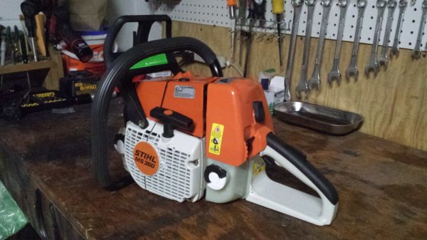

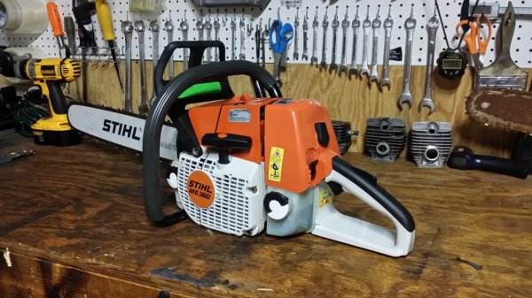

    Plastic was Hutzl as well, looked good for the 360, but they say it's for an 036 as well. Only problem, is the 036 was a flat top with a name badge and 360 is slightly contoured on the top. Because it was a 360, I had no problems. I even put OEM stickers on it. But to use it on an 036, like Boog? It wouldn't look right (to resell), unless it was a personal saw, that you just wanted to freshen up.
    As for the 360? You seen it. It looked good :)

    Felt good too, which is just as important IMO.
