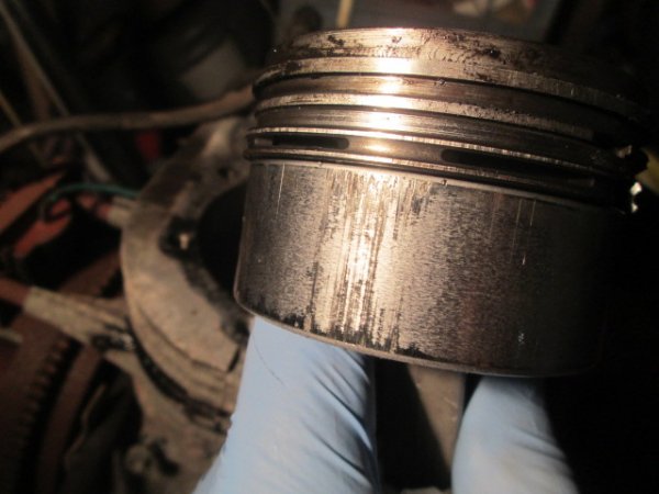

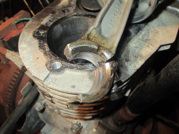

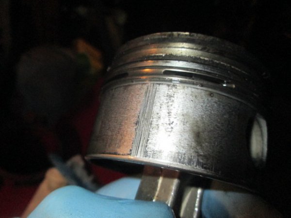

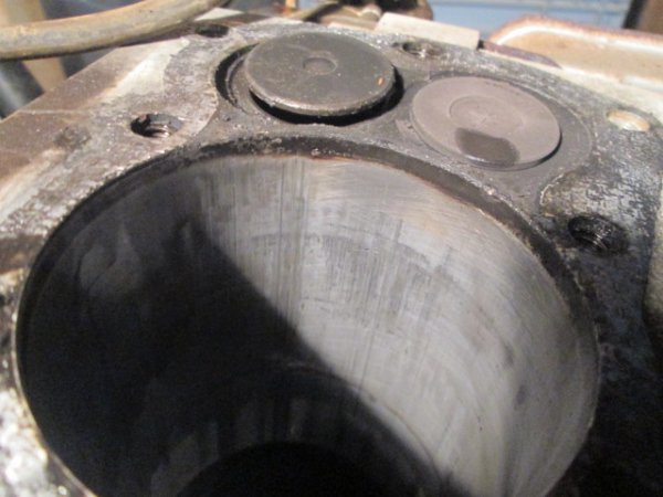

    So I was out using the snowblower today and right at the end, it started to get loud making a chaw, chaw, chaw sound and getting really loud. It went KA-CHUNK and stopped. Crap. I get it into the basement and remove the cowlings and top of the engine. After it cooled I worked the flywheel and jammed my finger in a fin and the coil thing which hurt like heck. The cylinder went up and did not go down. I pulled it out and yeah, the connecting arm is done for. I checked the cylinder and there is just a little scoring on the lower end of it in a small area. It is very minor I think. The piston has two score areas, one a little deeper that the other. The piston came right out and the cylinder walls were covered in oil. There was no fight getting the cylinder out. Taking the top of the engine off there were two bolts opposite of each other that were loose and the threads were oil coated. I think these two bolts leaked air at the gasket and there was a bit of a carbon ring at the top of the cylinder.
    So, go easy on me here, I have not done more that changing oil on my truck and replacing plugs. I have this torn down pretty well and will have no problem re-building it. Some of my descriptions of parts may be off, but I think I can get the point across. I have a few questions based on the pics.
    One question is where the bolt pushed through to the inner ring of the lower connecting arm, I think the crankshaft where the connecting rod meets may have been scored. Any concern with that? You can see where the the threads pushed through a little.
    Two views of the piston. Replace it?
    Slightly deeper.
    Top of cylinder, carbon build-up.
    I did watch a brief re-build on Youtube to familarize myself with what I am geting into. I will order new rings, head gasket, gear case gasket and a connecting arm. I am going to tear off more this evening and
    inspect the crank shaft. Everything turns smooth otherwise.
    I guess this was a good time to happen as it needs new belts as the transmission and throwing capability were starting to decrease, so I will really tear into this thing. Thank you all in advance. I never though I'd be posting questions in the power equipment forums.

    Your probably gonna find out that the cost of the parts are not that far off a replacement motor. The days of rebuilding those single cylinder air cooled motors have passed. They are designed with a 300 hr life span on purpose. If you go to Tractor Supply or Harbor Freight, you will see the economics are there to just replace the entire motor.

    The snag here is going to be the crankshaft. You really need to measure the journal surface and make sure it is in spec. Scoring is no good either. Slight imperfections in the cylinder wall below where the piston rings travel are no big deal but when a connecting rod lets go in one of those, 99% of the time the engine is scrap. There used to be short blocks available for reasonable $$, I would enquire as to the availability of one of those. That will replace every moving part of the motor and you simply transfer the head, flywheel, carburetor and other supporting parts to the new assembly.
    Without knowing exactly why the big end of that rod let go, I wouldn't trust that engine.

    Did the connecting rod bolts come loose and the piston hit the top of the head - unless you loosened that bolt that's the failure mode.
    Like MM said above check the journal on the crank, if it catches your finger nail or other soft material....its pooched;) and time for Chinese knockoff replacement
