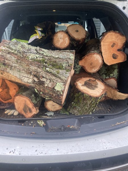

    Little scrounge on the way home
    Could’ve gotten more but there’s an AC unit under the pile.

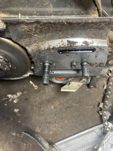

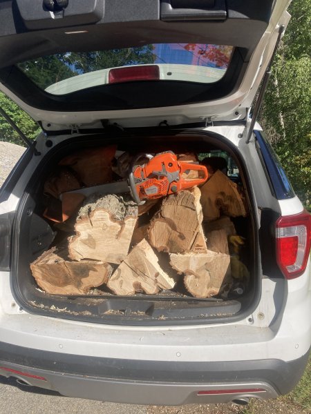

    Got some more today. Today I brought a saw. Cut this 24” DBH maple until I noticed the clutch cover sloppy. More below. But got a partial before I went to get another saw.
    Second load
    the modest pile.

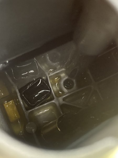

    And the stupid bar nut
    Never had this happen.
    And the saw was running mint, 572, huskihl

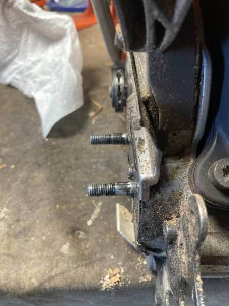

    Tap it back through from the oil tank. There’s nothing fancy inside there, just a big square head that fits into a recessed area :yes:

    so does this saw
    operator error I’m guessing
    Maybe put it away half arsed at some point

    Ive done the same. Forget to tighten them when switching bars or swapping chains and have the bar loosen when starting the cut! :doh: Were only human Mike!

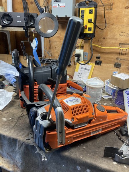

    2C4D9F2A-A5A9-4548-972B-FD3D4B36909A.jpeg 42241D5E-5193-4B87-B344-9BCC4023DBC1.jpeg 14DB0767-036A-4BC1-ACAA-6F25FFC2B987.jpeg 608071A3-3AD6-4482-9B03-09D08EC6A7E8.jpeg
    Hardest part was draining the oil out first.

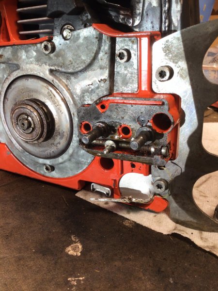

    Torque I guess
    Only bar nut work I’ve done thread through the case, until this one.

    Most huskies are like that. It’s a snug fit.
