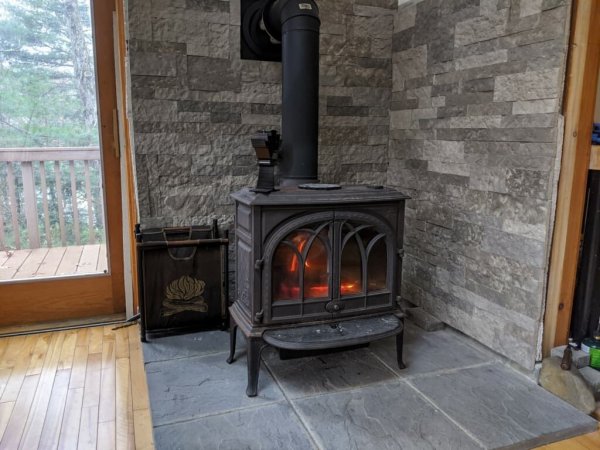

    Got it all inspected and passed yesterday! Older 2-door F400, 15' of Shastavent, lots of mortar, airstone, and durarock. Just need to do the finer work now like molding around the heart and side walls. In all it cost about $1,600 (since the stove was free). Doing lots of reading/watching on here and youtube was very helpful. Cars and brains are my thing, not home projects so this was a decent first success.

    It's gorgeous! I once had a castine (single door) so ask away if you have any questions!

    Thanks! Definitely still learning it. Realized the other night my thermometer was incorrect and reading too high so now I'm finally seeing heat production after I thought I was over-firing (thought it hit 750*+ last week but in reality it was about 550*). I was previously running it around 350-400* and not seeing a ton of heat. Cruising at 500-550 is great heat. I'm realizing I cannot get lots of heat overnight in our 1500' home but 4-5 hours is very nice and beats hundreds of extra a month in electric and oil.

    You betcha! I had over drafting with mine, so a little metal tape over the outside air cap helped.

    Looks great.
    :yes:
    Nicely done

    A pipe damper will give you a little longer heat times.

    Wow, that looks really nice, great job.

    Nice job. Really like the walls.
