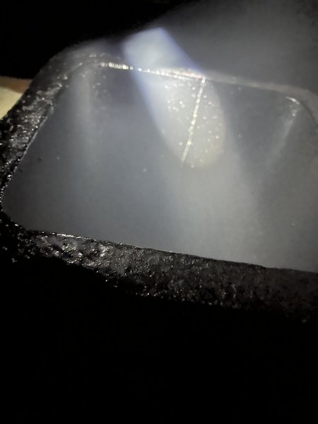

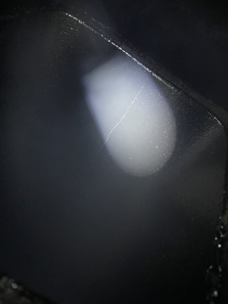

    Well unfortunately, I noticed my top terracotta has a crack in it. I have a wood stove in basement, and I only burn seasoned oak wood. I don’t have a moisture meter, but my wood is three years old now. These are some pics I just took when I got off work. Is this ok? can I still burn the rest of winter? Just asking for some help. I really don’t know, I was thinking since it was at the very top of chimney I’d be ok. B5263A72-A210-4E5E-85C5-E04B987E452A.jpeg

    You could clean it up and hit it with some mortar…
    2000ºF Fireplace Mortar - RUTLAND Products
    Question is whether that is an indication of what the rest of the chimney is like. . Cracks further down could be disasterous in the right situation. it’s tough to say what the right answer is.. if you burn dry wood, and aren’t prone to a chimney fire, you could be good.. but one chimney fire, or a case of carbon monoxide leaking into the structure, and you could be in a pickle pretty quick.. not to mention a denied insurance claim for using a known to be damaged chimney. might be worth a whole chimney inspection, or might be best to line the chimney with a stainless steel flex liner.. what kind of stove are you burning? When was the last time your chimney was inspected?

    The previous owner said he had the chimney inspection and I was good. I got on the roof myself, and sweep the chimney with a brush. That was 2 years ago on the inspection, but everything looked good then, and I didn’t notice a crack.

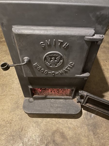

    Interior or exterior chimney? How many floors is the house? Do you have a copy of the inspection report? I think the standard now is to use a camera to inspect the inside of the chimney. I’m not a pro, but I think any cracks would put it out of service.. loos like that stove has an 8” outlet from what I looked at online. Looks like a big stove. Personally, I’d do a stainless liner.. just one man’s opinion.

    Interior, and just one floor then the attic. Yes you’re correct on the stove, and it’s a pretty good size wood stove for sure. It’s my main heat source, just wondering if I could get bye this winter. But then again, I’m not a gambling man…….that’s why I reached out to you guys. I’m sorry, I asked my wife on the inspection for the chimney and she can’t find it.

    Yeah, this is a tough one...hard to tell much from just that one pic...might be a hairline crack, might be worse...and without a full camera inspection of the whole flue, its hard to say how risky it is to continue using....for me, part of my decision process would be how clean my stove burns...if I have good dry wood and I know my stove burns clean and there is never any buildup in the flue, I might be temped to run it just long enough to order a liner and insulation kit.

    My thoughts are, if it's cracked at the top where you have little heat I would be curious of the remainder. I would just drop an insulated liner in place for safety first. At minimum I would have another inspect done if you forgo a liner.

    Thank you guys, we looking into getting the stainless liner. It just doesn’t set well with me having that crack. We have shut down the wood stove till we install the liner. Once again I really appreciate for all the help and experience.
