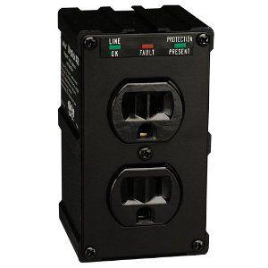

  11. imacman
    imacman
    Oct 23, 2013
    6,528
    27,025
    Denver, NC
    TrippLite UltraBlok.....a lot of forum members use these. About $24 on 'Zon last time I looked.
    slvrblkk, badbob, BHags and 3 others like this.
