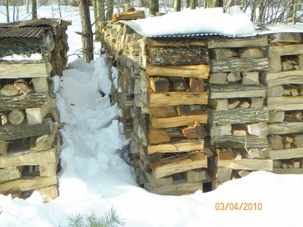

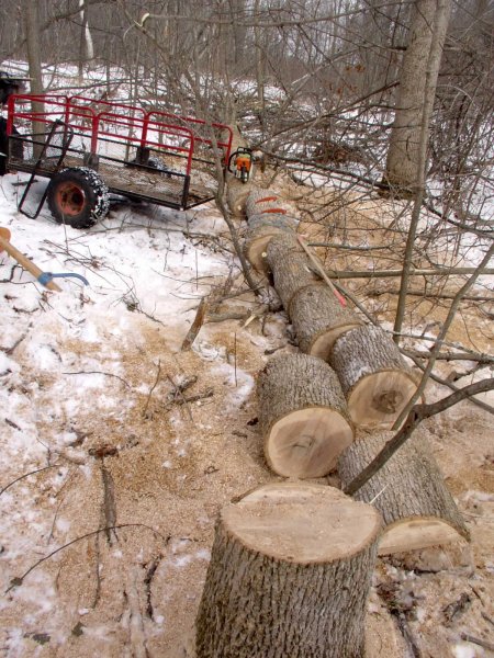

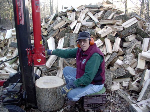

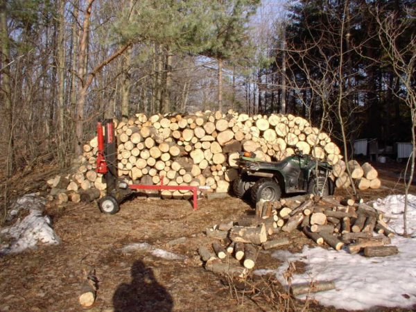

    On the making and covering of firewood, here is how we do it. Generally we cut in winter and sort of stack up the rounds. As the weather warms and the snow melts, we then get the splitter out to do the splitting all at one time. Then we stack the wood. This is normally early or mid April when we finish the stacking. We do not cover the wood immediately as we feel leaving it uncovered in that first summer will allow for the best evaporation of the moisture. As fall turns into winter we then top cover the wood. If it happens to be a really wet fall we will top cover earlier. Then we just wait as all of our firewood stays in the stack for 3 years or more before we're ready to burn it. And to answer the question now, no, all firewood does not need 3 years to dry but if you learn about the benefits of the 3 year plan (you'll read lots about it here), you will no doubt want to do the same.
    Also, your area tends to get a lot of rain and your wood very well might benefit from being top covered as soon as you get it stacked. But remember, top cover only; do not cover the sides of the stack as you need air circulation to dry the wood.
    Here is a sample of some of ours (note that we use old galvanized roofing for top covering):
    Another load 12-31-14.JPG Ash-1 1-16-15.JPG 3-6-09a.JPG Dennis Cook 4-4-09c.JPG Christmas-2008d.JPG Wood-3-4-10c.JPG
