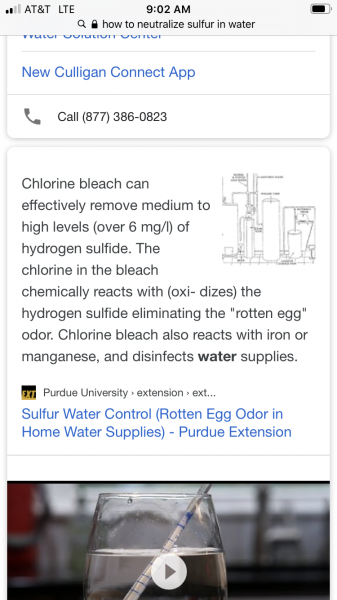

    346A6C2C-B10F-46CB-8718-61D50145FEA4.png We use bleach. Just plan on washing a bunch of cars the day you flush the well.
    It doesn’t last long but it helps
