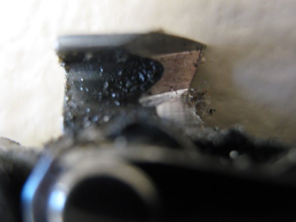

IDK, its for fast wood. It has aggressive forward lean, 30degree top plate with a hint of side beak. Thought I make a cant chain for GTG. I don't know how much faster than OTB. I did a 3/8"LP with same angles that was 30% faster on a mm261cm that's proven to be 40% faster. So over all gain was 70% faster than stock
If it's like mine? Then it's FAST!! This was my 261 (may be the same one talked about above) with one of his chains. 261 with Square PS (new):
