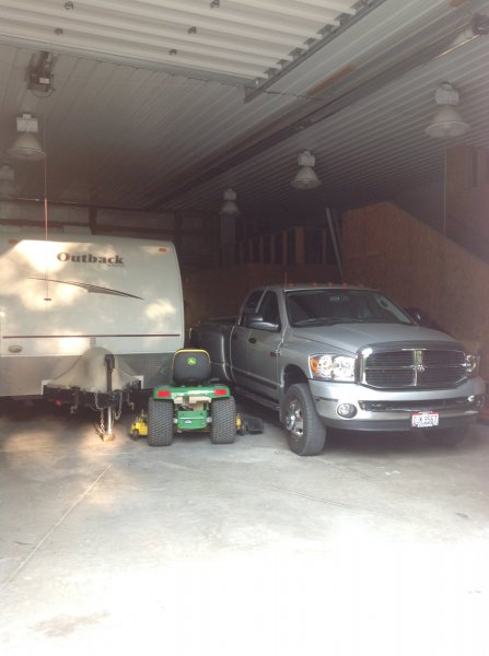

    I have a pole barn and heat it with propane, but only turn it on when needed. It's pretty well insulated also and stays roughly 20- 30 degrees warmer inside than outside, most likely due to it being on a slab and well insulated.
    A 110 electric heater at 1500 watts produces 5,000 BTU's per hour.
    I have inferred radiant heating tubes that use 125,000 BTU's per hour. It heats things (mass) and no so much the air, so you feel warm really quickly (10 minutes) when using the garage. If I use the garage a lot in the winter it adds about $50.00/ month to the propane bill, but it's really warm when doing so.
    I guess it comes down to how often you need it heated up. I would guess propane might be your most economical choice, unless you want a woodstove?
    Here's a pic...
