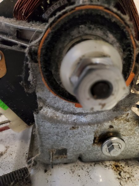

    Replacing the Idler pulley on my dryer and it appears I over tightened the screw and apparently stripped or widened the threaded hole. Any advice?

    JB weld

    Seriously meow... can you tap that hole to the next size? Real question/suggestion.

    I think the JB Weld is what I will try.
    You funny Eric!! Not sure if the location of the hole can be relocate and still activate the drum switch

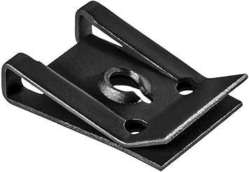

    I've inserted an appropriately-sized piece of a zip tie into stripped holes and then inserted the screw with some success. I think that's a long shot here though.
    It looks like you might also be able to insert another piece of metal behind the stripped hole. The metal strip would have a hole in it and would need to be longer to allow you to keep it from turning while tightening the screw.
    You could also drill a hole next to the stripped hole and install a u-nut like the one below.

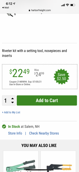

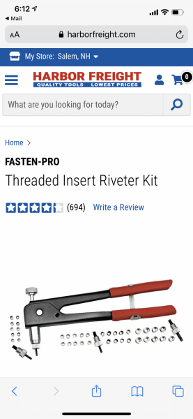

    4,422
    Salem NH
    Wow, I never heard of these before!
    That is good info and Harbor Freightie has a nice kit!
    Threaded Insert Riveter Kit

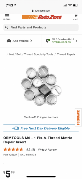

  19. don2222
    don2222
    Nov 10, 2013
    3,263
    4,422
    Salem NH
    Looks like a very good option from Au
    Looks like a very good option from Autozone

  20. brenndatomu
    20,531
    127,900
    They work great (the nut-serts...I'm not familiar with the HF kit) especially if you need to put machine threads on the back side of a blind panel, or just don't want to fool with a separate nut on the back side...
