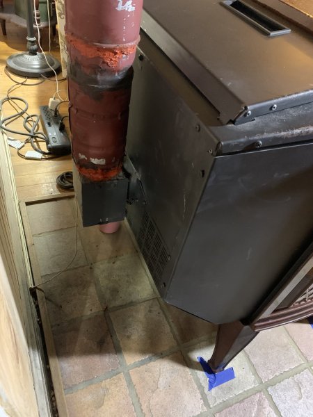

    I just replaced the convection motor and the combustion motors on my 2006 Castille. (Third combustion motor and second convection motor) No problem and stove running good.
    PROBLEM: Smoke coming out of the right angled clean out joint, at the bottom of my stove pipe, on start up, is telling me I don't have a good seal. (First piece off the stove is the clean out box, at the bottom of my stove pipe stack) I put the high temp silicone on the inside bottom end of the round clean out part that goes INTO the stove and slides over the pipe that is part of the stove. Did it twice and still have smoke. Did I not put enough silicone on (the gap between this connection is probably no more than a 1/4") as I must have had 3/4" on the last shot? Or, am I putting the silicone in the wrong place? If I put it on the end of the pipe part that is part of the stove itself, and slide the clean out connection over it, I assume I am going to spread the silicone over a wide surface and never get a seal, correct? As I have a tight 90 degree bend at the top of the three foot stove pipe, before it goes straight back into the chimney, I have to insert and slightly twist the bottom of the pipe with the clean out upward (can't put the bottom of the pipe straight into the stove) to line it up with the 90 degree bend on the top. Pics of the set up below. Can't run the stove until I have no smoke... IMG_1174.JPG IMG_1175.JPG IMG_1176.JPG

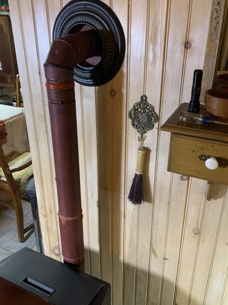

    Is it me that the exhaust pipe looks rusty? How old is the vent?

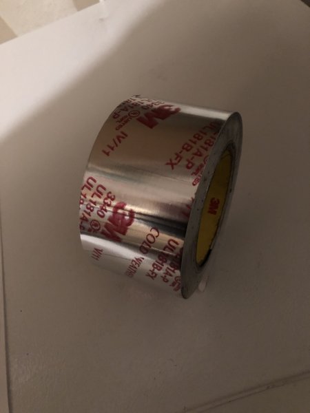

    I use this stuff. Probably the same stuff BHags is talking about. Works great. Makes a really nice, night seal. Doesn’t burn up. I bought it at Ace.

    That is the point, the silicone did not seal properly in the clean out connection to the stove. Since running the stove for a few days intermittently, the seal in that joint seems to have expanded and contracted enough to make a good seal. The stove pipe above that joint will be reviewed in the spring and as it is 15 years old and not a great expense, replacement is on the table.

    We painted the pipe years ago to match the stove, so your eyes deceive you. Once spring shut down arrives, will consider replacing the 15 year old pipe as the expense would be minimal.

    Nice! Will check it out on my next visit to Ace.

    I meant tight seal, not night seal! I’m sure you figured that out.

    TLDR......thats crappy old Simpson pipe.....might I suggest replacing it?
