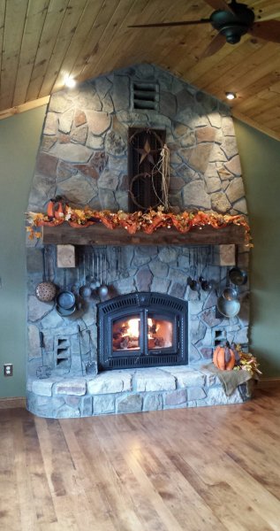

    We have a freestanding Napoleon 1900p in the kitchen and a modern Napoleon NZ3000 Zero Clearance fireplace in our living room. Both are AMAZING heaters and very efficient. I love the look of a traditional fireplace but wanted a high efficiency stove and that's why we went with a ZC unit for the living room.....it looks old fashioned but is VERY modern and efficient.

    Well it's already been said but I agree an insert is to retrofit an existing fireplace when one can't easily accommodate a freestanding stove. It doesn't really make sense to build new and use an insert. A zero clearance fireplace maybe, but not an insert. Scotty Overkill yours does look very fantastic. :yes:
