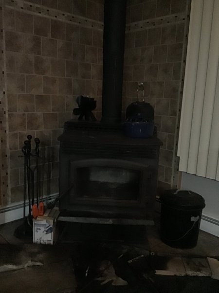

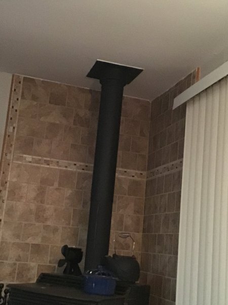

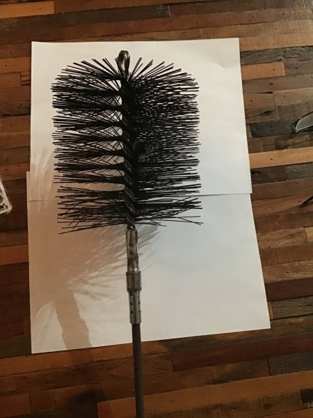

    Hey, Joe! Hi. I just found this old thread, but I’m just in the process of trying to clean my flue for the first time. I have a Enerzone Solution 3.4 stove also. I took off the tubes and baffles. I have the cleaning brush and (I believe) fiberglass 6’ rods that were left in my garage by the previous owner of my house. The brush seems to be pretty rigid metal and it’s 6” wide. It’s a very tight squeeze to get it up the flue from inside the stove, and it’s also tough to make that turn with the rods I have. Which rods did you get? …and which brush did you get? I’m thinking of ordering a poly brush instead of the metal one I have. Also wondering if previous owner might’ve taken the flue apart at the ceiling to clean it? Thanks for any guidance.
    Oh, also, flue goes straight up thru the roof, but the top of it is about 7’ above the roof.

    A poly brush is usually recommended for steel pipes.
    I have fiberglass rods but they are far too rigid for bends. I'm sure trying would damage something.
