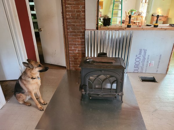

    We scored a used Jotul F500 4 weeks ago, and have chimney folks coming to do some light mortaring, and drop my (double wall insulated) liner down through. We scored a 20g piece of sheet steel today, to be our hearth.
    My question is about the hearth: the (galvy) sheet steel almost doesnt need to be tacked down. But I would like a way to transition the edges. I also.have high temp paint, but am wondering if its worth painting?

    Welcome to the club, lots of great folks here sharing knowledge and humor. What do you want the edges to look like? I don't think it's very thick, might could do a small trim around it. As far as paint, don't know how good it will stick to the galvanized, it would have to be cleaned really good.
    Any scratches will show thru easily though.

    If there were a good tape, I could see taping the seam....it's not that tall, just want to keep socks from catching. Even a bead of caulk would tool out nicely.
    DW washed the metal in anticipation of paint, but i kinda like the bare metal look. As much as we'd possibly scratch the paint, it could be easily touched up I reckon.

    I also used durock on our combustible walls....kinda short on wood burning folks around here....so cutting my own path. Either way, durock is up, and I'm thinking about painting it. Stove and or high heat paint comes to mind.
    Unless there are alternative finishes.
    Black would absorb heat to the small amount of thermal mass there...

    Are you meeting the clearance to combustibles requirement for that stove? Putting a non combustible in direct contact (no air gap) with a combustible offers almost no reduction in clearance required...unless it is an approved high R value product.
    The easiest way to reduce clearances is to put up a sheet metal shield spaced 1" off the wall with non combustible spacers, and 1" up off the floor to allow for air flow behind the shield...this will often buy you a 50% reduction in clearances required (to a point...there is always still a bare minimum)

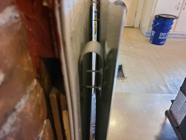

    So when the stove mfr says x" from a combustable surface, does that mean fromnthe sheet metal protecting it, or the wood an inch and change behind the sheet steel....?
    The steel ended up being 1.75" off the wall...was a fun install as I don't do too much metal working.

    For those looking for an option to mounting sheet metal to a wall: galvanized 9" straps (electrocal section lowes) bent around 1" steel pipe, and #6 machine screws and nuts to hold it together. Use a few of the same straps bent to 90* and bolted to the bottom to hold it 1" off the floor. 20201019_120815.jpg 20201019_120404.jpg

    Stove (or pipe) to the combustible surface
