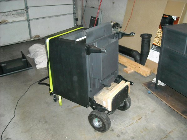

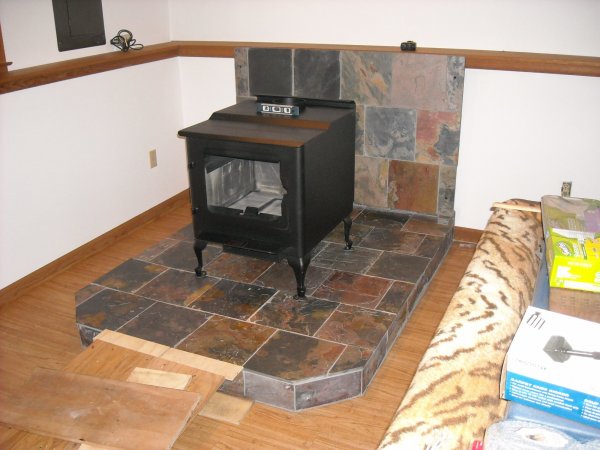

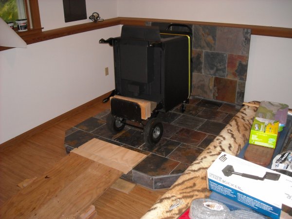

    I started at 10 am. Their are three of us....Me, myself and I.

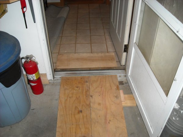

    I had my doubts about the hand cart I had bought when I picked up the stove, but it was very useful.
    I had the cart in the four wheel position when moving up the ramps, then switched the handle on the hearth and got the stove down very easy. Then I put some sliders under the legs and positioned it.

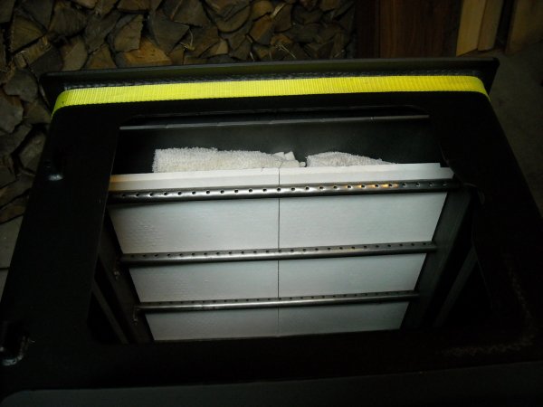

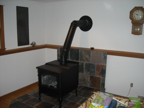

    I had put some rags on top of the baffle plates, gotta remember to remove them.
    I also painted the bottom of the stove.
    So far the worst part was removing the pedestal.
    All the clearances have been exceeded.
    Is the stove pipe all right the way I have it? Or should I just come out the wall and use a 90 then drop into the top of the stove?
    I didn't screw or seal any of the pipe yet, figured I wait and ask about it.

  2. papadave
    Um, where's the fire?:dex:
    Looks gooder to go.
    Canadian border VT and HDRock like this.
  3. HDRock
    17,248
    60,351
    Looks good man, I know you are going to burn less wood with that.
    I have a cart like that I've had for a long time, I used it to haul the old stove out but I just used a different approach with the new one coming in.
    I think its better the way you have rather than just one 90 degree bend
    Canadian border VT and papadave like this.

    Agree.

    Looks great! So jealous wish I could have had mine hooked up before all this rain headed my way.

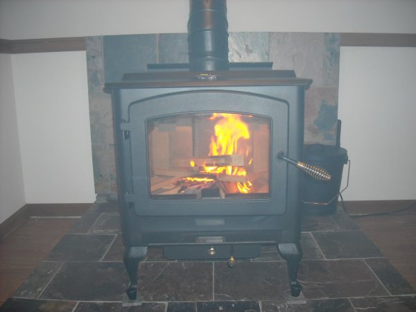

  6. HammerheadC4
    HammerheadC4
    Dec 9, 2014
    153
    674
    Eastford CT
    Thanks guys.
    I got a fire going in it, I got it holding around 400, got the windows open with a fan in the stove room.
    Seems like it's taking forever to burn a couple splits down. (just kindling in the pic.)

    I got it running to get the chill out, got the upstairs in the low 70's now....that's with the STT 400
    I placed the stove top thermometer on the just above the bend on the upper deck...is that a good spot for it?
    I been wondering when I'm gonna get to see the secondaries.
    I do find myself watching the flames...I keep reading the manual when running the stove. I just got the hang of the last stove, now it's back to square one LOL.
    HDRock, Norky and papadave like this.
  15. papadave
    Where you have the gauge is the hottest spot on the stove.:thumbs:
    If you got the stove to 400, close the air down so the handle is just under the ash lip or a bit further.
    You'll see secondaries. Stove temp should climb a little too.
