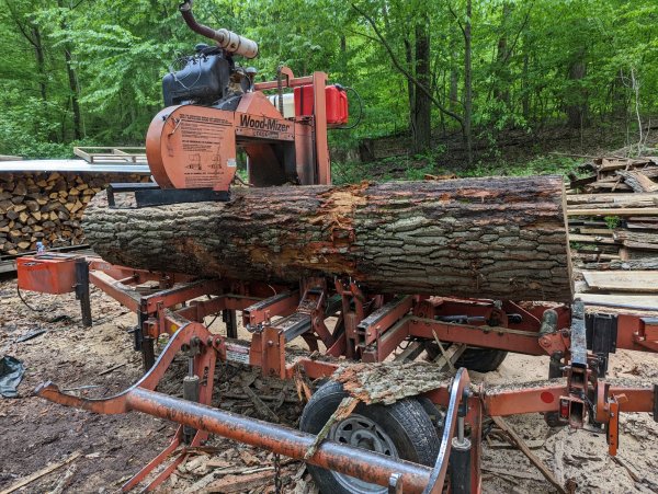

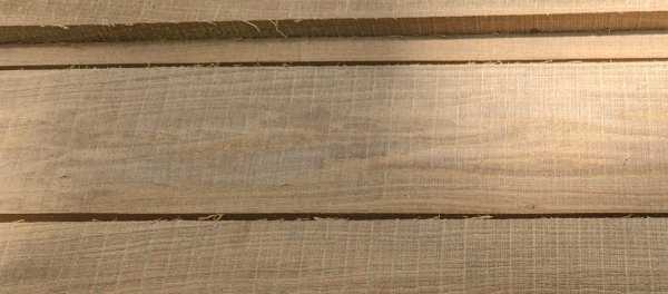

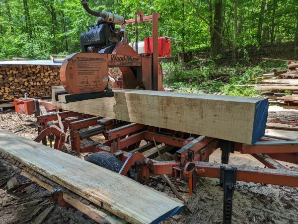

    I've been harvesting many (~5,200 bd-ft of logs) recently dead oaks from my forest over Winter and Spring. Today, I finally got started on milling. FWIW, I hire out a portable miller and just do all the manual labor of offbearing, stacking, etc. Today we sawed only chestnut oak. Some really nice boards and some o.k. boards. PXL_20220517_163716203 (1).jpg PXL_20220517_170428122.jpg PXL_20220517_154235500.jpg

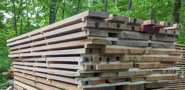

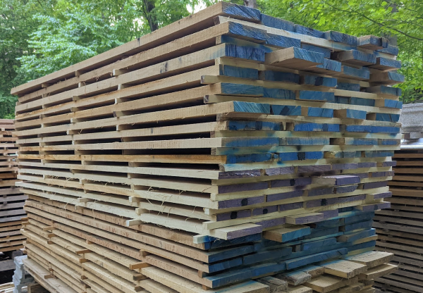

    Finally got started stacking and stickering the lumber we sawed Tu-Th. It was zero fun in 90+ degree weather. For the record the blue is chestnut oak, the purple is white oak and the unlabelled is red oak. Black dots are quartersawn.

    I sawed all types of boards. The best logs I sawed into 4/4 - 6/4 as wide as possible. The lower grade logs I sawed into 1.5" x 8" x 8' trailer decking or 4x4's. Yes I would love to sell it all eventually, but no specific plans yet.
