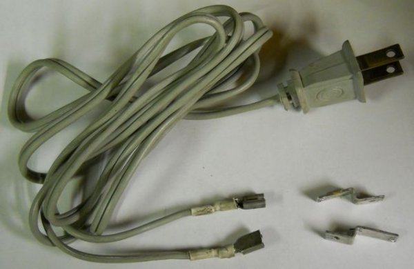

    BTW, as most of us know, these auger motors are pretty tough, and I'd be surprised if it was really bad. Does dirty stove/poor airflow/lack of vacuum switch closing sound familiar to anyone?
    Smokinpiney, I suggest you make yourself a simple 120v power jumper lead like many of us did, to check to see if motors are actually good....an old lamp cord works great:

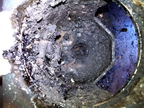

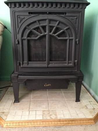

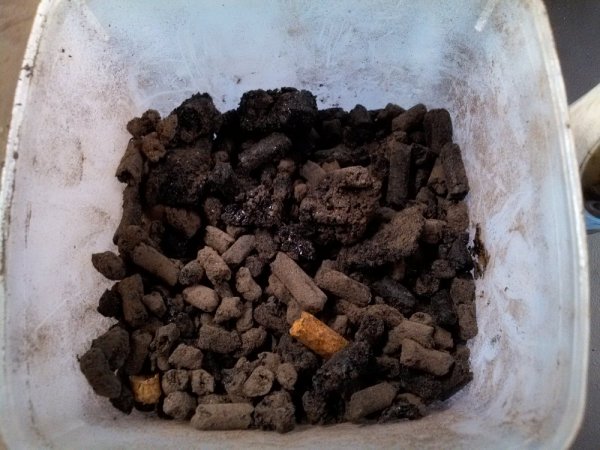

    Well i have officially joined the pellet heads club! Managed to grab her for $450 including the pipe, thimble, and home made hearth pad. Holy cow is this thing gummed up :jaw: . I don't know what he was doing but as you can see in the pics something wasn't being done right. I got right to tearing it down when i got home and the auger and pellet chute were completely locked up with creosote and unburnt pellets. Once i was able to get the auger and motor out i tested it and it works! But the cam and shaft/cage weldment are pretty much toast. Something wasn't allowing the shaft to move freely and it wore down the cam and the part of the shaft it pushes against. Im really wondering if this guy mistakenly bought a some bags of smoker pellets because all the creosote has a sweet bbq smell. I smell like bbq ribs right now haha. I'll get some of the tear down pics up in a bit. But here's a pic of the stove :D

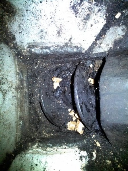

    Ok here's some tear down pics
    Looking down at the auger in the hopper
    Looking up through the auger hole from the back (after i removed it)
    The auger

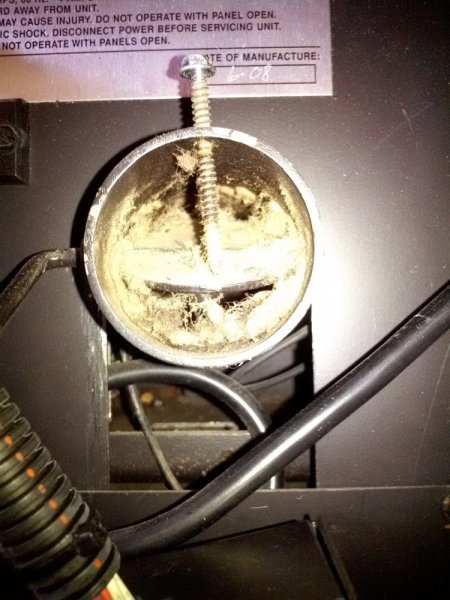

    Combustion air intake

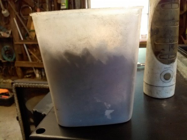

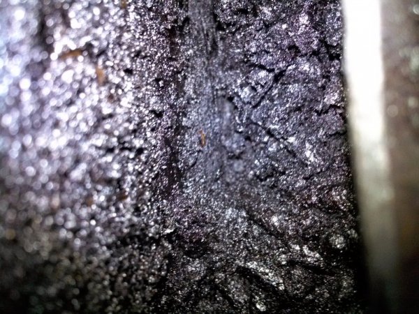

    Looking up the pellet chute from the burnpot. It's hard to tell but that's completely clogged!
    Just some of the creosote/pellet mush i pulled from the chute and auger area

    Dang that thing was dirty.
    I'd gamble that it will burn just fine once you get the cleaning done.

    Dirty ain't the word! I had to pry the auger out with a large screwdriver.

    Holy chit that thing is dirty .doesn't look like it could get any air .

    That stove makes some of the pics that Don has posted over the years look like normally operating stoves.
    Once you get that critter all cleaned out, I'd put it in the driveway, crank it to 11 and let it run for a couple hours and burn out everything else that is left over. I'll bet once it can breathe good again that you'll have a nice stove for a good price.

    That's my guess for the majority of the stoves burning issues. Yes, he may have put smoking pellets in it, but those pics sure look like just a complete lack of combustion air......the pic of the air intake pretty much confirms that.
    As has been mentioned above by 343amc & will711, once you get everything nice & clean and working, I bet that burns just fine.
