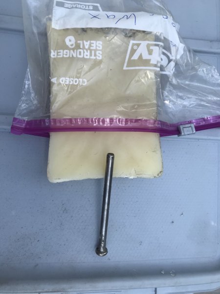

    I say you catch more with honey, so I got out the old bees wax!
    Then I cleaned and waxed the hinge pins, 30 in all.
    Now quiet as a mouse!

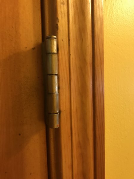

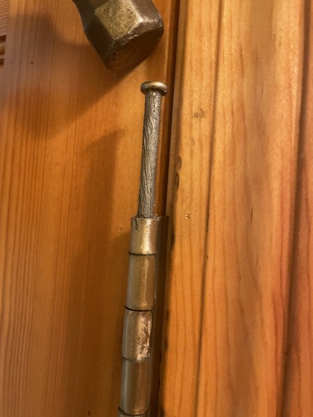

    Update!

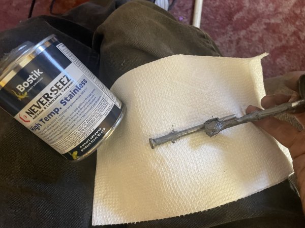

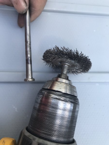

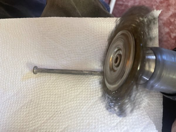

    The Bees Wax was an old carpenter trick that did help for a while. It does pick up dirt and gets harder. So now they are back squeaking again. So this time I got something more binding! Not the cheap generic brand, not the name brand bargain can, not even the middle of the road works in many cases brand! I pulled out all the stops and went all in on the top of the line Premium High Temperature Stainless Steel Never-Seez[​IMG] Maybe this time, for the first time, we will win??
    Pic 1. Clean
    Pic 2. Paste
    Pic 3. Install
    Hopefully this will make for a nice quieter Memorial Day weekend! LOL
