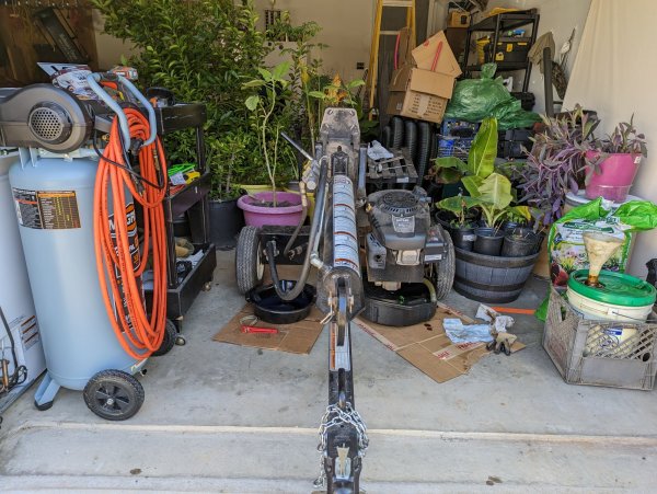

    Changed the hydraulic fluid and filter today on my country tuff splitter. I'm ashamed to say that this is the first time in the 9 years I've owned it. I was surprised, the fluid was bright a clear. Filled it with new fluid halfway between the min/max marks on the dipstick. While cycling to purge air I was getting a lot of fluid coming out of the vent hole. Also noticed wouldn't bog down unless I held the handle down for several seconds on the end stroke. Still air in the system? PXL_20221117_171400735.jpg

    Did you fill it with the cylinder retracted? If not, you overfilled it. There should not be air in the system as it constantly circulates. If the oil was clear, it was still good. I have not changed my fluid yet, and it has been over 10 years. It still looks brand new.

    Yes cylinder was retracted. It may have been a little more off level to the vent side then I thought. Ran it today splitting some red oak without issue.
    I'm sure the fluid was good, but I had noticed a leak at the top of the filter and the rim was discolored brown so I figured I'd change both. Embarrassed to say the filter was loose , never thought to check the simple stuff first.
