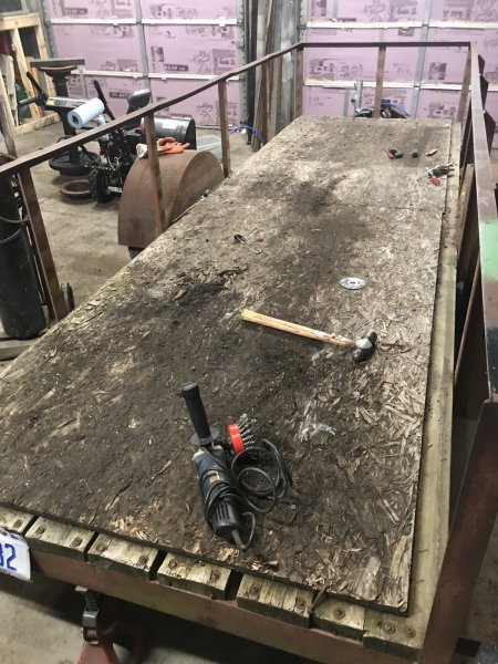

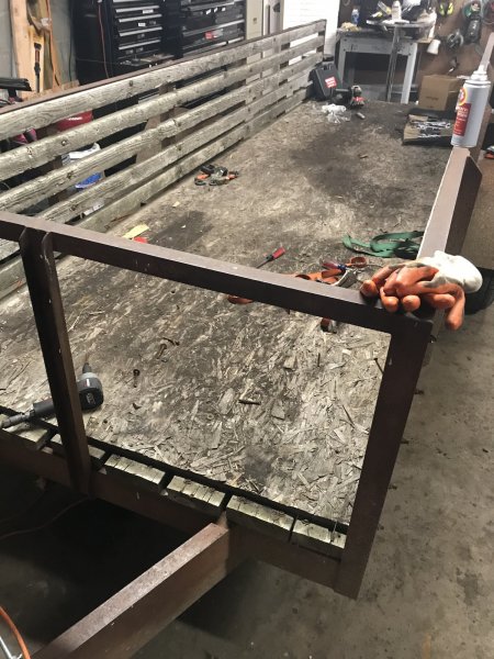

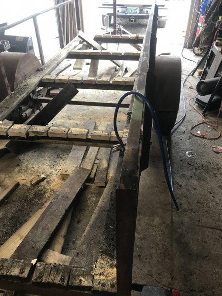

    The bearing on one side is bad and the leaf spring on the bottom pushed out so I beat it back in today.
    The deck is so bad I laid what I had at the time to get by OSB.
    I can’t put it off any longer. It’s just time.
    The plan is to do a few modifications to the trailer that have been a dream for a long time. Flip the axle and slide it back, build a drop ramp gate, put a winch on the front for pulling things into the trailer bed and get it blasted and repainted. Maybe a tool box on the front MAYBE...
    Either way it’s got about a month and a half to get done. We need it for a lot of projects this year.

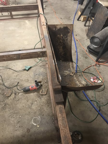

    Got it out now. The other side still had a break plate and it fell off while taking the axle out. All but rusted off... looks like the other side was cut off and ground smooth. 17AB5ABE-C4F9-4AF7-93EC-39FB3C5C3714.jpeg

    I am currently looking for new leaf springs I took them apart last night and most of the right side where either cracked or flat once I get them separated. EBAY AWAY!:hair: Actually I am kinda glad now I dont need to paint them:whistle:

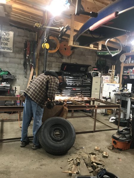

    Fender getting cut off man whoever built this put A LOT of welds on that fender lol...

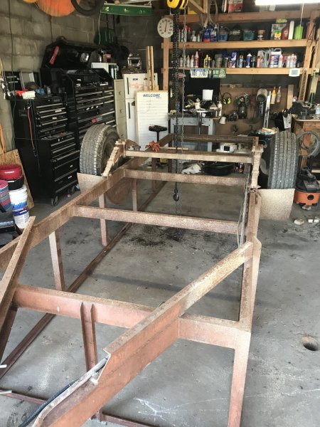

    Well update time... After a very long exhausting morning we have talked to countless trailer builders and supplies shops, driven from Lansing to Grand Rapids and back and I have just about worn my brain out.................................. There isnt a single trailer supplier in 150 miles who can get me the parts or replacement springs for the trailer that meet there 10 leafs and length. :headbang:
    I just finished emailing State Spring out of Lansing in hopes that I can take them in and get parts to fix them or have them made to the dimensions needed. Fingers crossed....
    We hit Menards on the way back and I broke down and purchased a diamond metal cutting blade for my Porter Cable metal chop saw. Supposedly it cuts straight, cooler and last much longer than those fiber discs Ive been putting on it for the last 4 years or so.. Its a good saw but the fiber discs get pricey in short order.
    ( pics coming ) Gotta get off my overly bummed out behind and go get to work with what I can until the springs get figured out....
