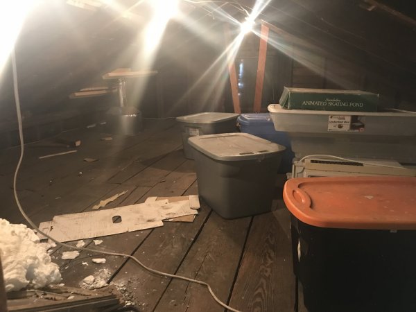

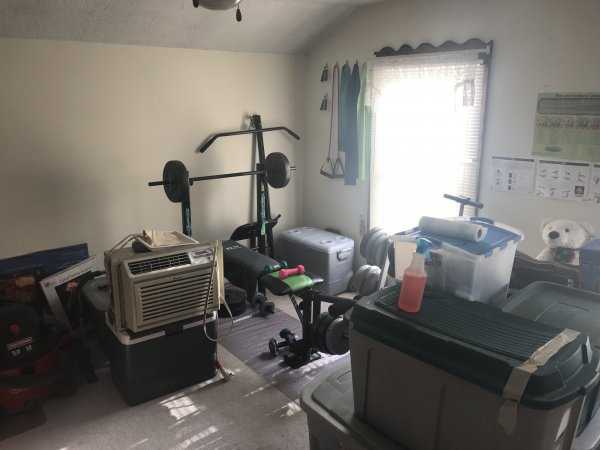

    we have an old house with a small attic built with logs as part of the framing.
    Yesturday started the empty and demo. Our upstairs fitness room is completely trashed and full of totes and there’s more to go...:whistle:
    There is A LOT left to do...
    We are tearing the old floor boards out and insulating then blowing in the area we can not crawl into.
    Lots to do.

    We have caught two bats and a mouse while cleaning it out. :dex:
    Today’s task is to empty and shop vac the whole mess out...

    In that section of attic space we are going to use R-30 bats in the floor and than re deck it with osb flooring. Hopefully that will work good. Also running a small recessed directional light to point at the stove and illuminate the stove just a little bit at night almost like a night light. The spacing is 14" to 14.5" width and 9" depth in the attic.
    Honestly I think I am gonna beef up the rafters there spaced at 24" so I want to add one in between so they are 12" spacing. That roof is a good one but the snow load scares me sometimes.
