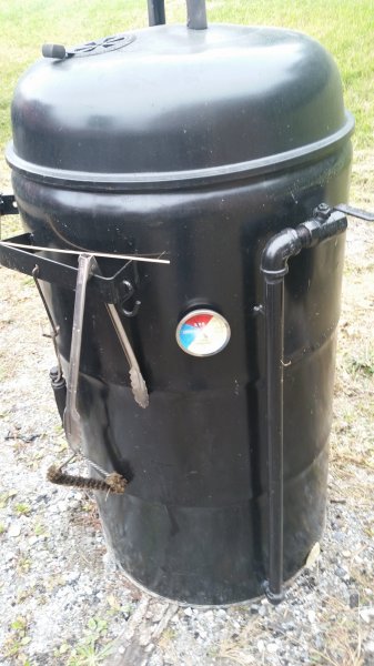

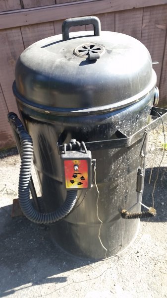

    55 gal drum...roll a fire basket out of expanded metal...weld some bolts or something on the basket for feet i also welded a bail on it...used a $4 pizza pan for an ash catch...put whatever style intake vent(s) you want on the bottom and get a cover from a 22" weber or knock off...i welded some 5/16" nuts inside the drum for bolts to support the grates that way the drum is not drilled full of holes...your gonna need a heat deflector too that can be fabbed out of 1/8 or find something you can repurpose....i put my first grate 8" down..2nd grate 14" down and deflector21-22" down dependin on how tall your fire basked ends up .....any questions just ask.. 20140907_100155.jpg

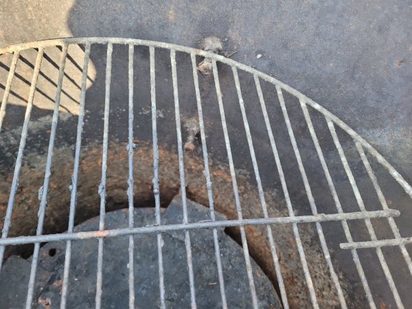

    This cooker is at the end of its life,but no problem...just get another drum and reuse everything...I've done this 3 times so far with the same components ...here's a pic of the nuts I welded in thats my heat deflector i forgot what exactly it was but i welded 4 tabs on it to catch the support bolts...that was a proto type since then i just burn them out(heat deflector) with the plasma 20210329_155707.jpg

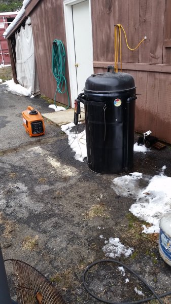

    my other setup is solar.....and the ugly drum can be run via natural draft....i was just using the stoker in that photo
