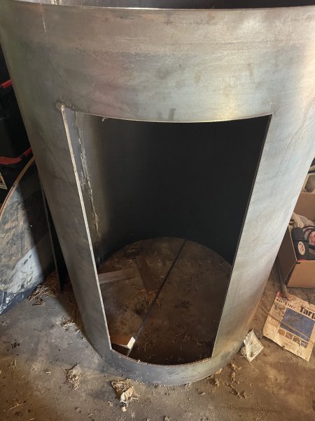

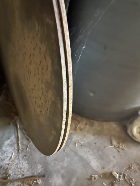

    I’ve had dreams of a big wood smoker for a long time. And it’s been sitting in pieces in the garage. I bought the metal probably like 8 years ago. Well I’m hoping to get it put together in the near future.
    Buts been a long time since I fired up the stick welder. What rods do I need to buy for this? Here’s a picture of the plate metal.

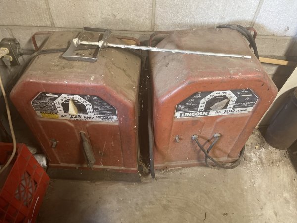

    I've got a big Miller at work. If it becomes too much of a issue, I’m sure I can talk to the boss about borrowing some wire.
    But I’ve got these two old timers. And the last time I used it for welder up hardware for my jeep. It did a good job.

  15. SKEETER McCLUSKEY
    SKEETER McCLUSKEY
    Aug 6, 2015
    10,779
    55,026
    Taconic Range
    tombstones....i got a couple too

    I've done a lot of welding with the old tombstones. Probably every farm or ranch had or has one and tons of 6011 rod burned on them. They get the job done. One advantage of the wire feed is the thin metal welding capabilities with gas shielding. Not trying to push you in any direction. Just introducing the opportunity to maybe upgrade and gain expanded capabilities in the process. We do like to spend other members money here at FHC and it doesn't always have to be chainsaws! Wish you the best of success in your smoker build!

    Note to myself:
    Main smoker body is 48.75” long and 30” ID
    Wood Box 19.5” cube
    1/4” steel
