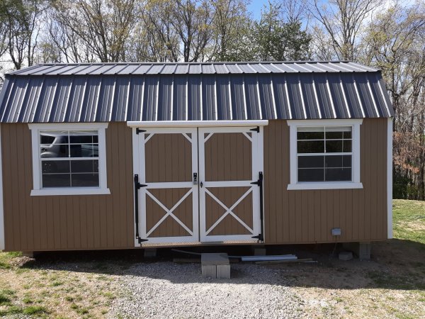

    Looking for a pellet stove for my 10x20 (r -13 insulated) shed needs to be small does anyone make one that small?

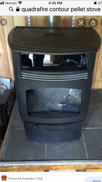

    I use a Quadrafire Contour the earlier model of the Quadrafire Santa FE to heat my entire 10 x 10 fully insulated shed. The wall t-stat keeps it very comfortable! The raised hearth is so I do not bump into it, and the front of the raised hearth is open and lighted for extra storage.
    Also I use about a bag of pellets per week. :0)
    It keeps my 10” pie warm too!
    See pic
