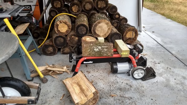

    I'm trying to split some hard fairly dry oak. The splitter is a little 5 ton Homelite from Home Depot.
    Maximum 10" around and 20" long. It goes through most pretty well even when they are up to 15" in diameter. But it doesn't like it if there is a branch in it, i had to use the sledge hammer to get it off the wedge. When the logs are shorter like 14-16" it takes a 4x4 behind to go all the way through.

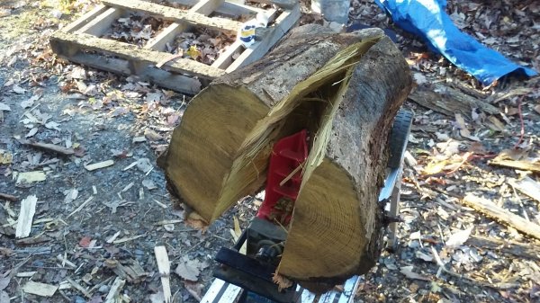

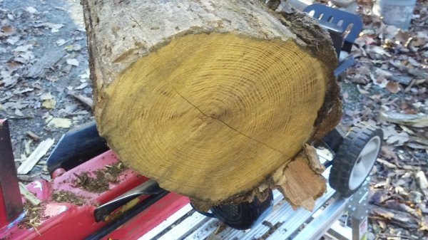

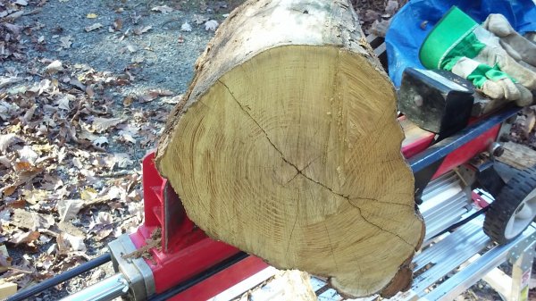

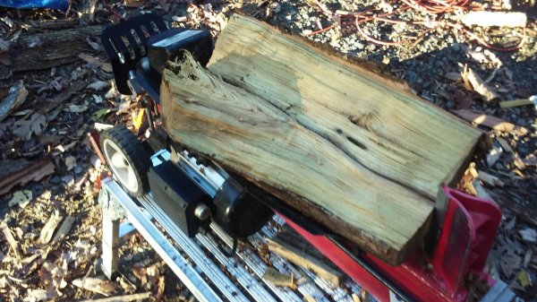

    I was out splitting when I came across a good one for "reading the wood" and thought about your post. Look at the locust round in the first photo, you can clearly see a crack across the face. You want to align that to the splitting wedge as the round is already wanting to split along that line. In the second photo you can see how the round easily split where it naturally wanted to go. Back to work, no rest for the weary.

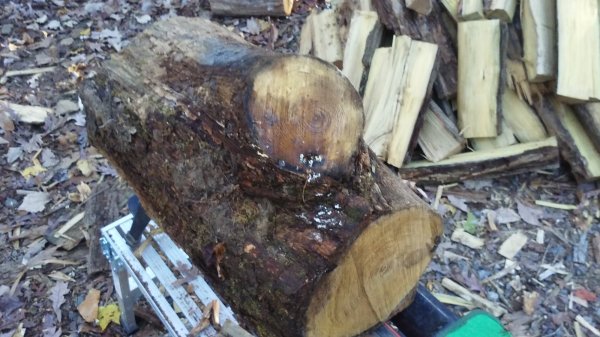

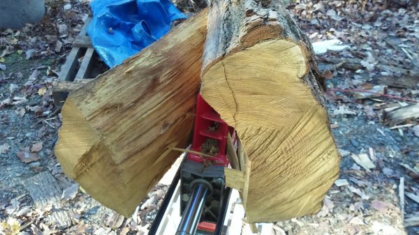

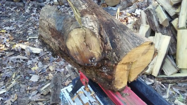

    Lucy I am glad that you posted this thread as I was planning on splitting today so I was looking for things that might help illustrate. Here is one with a limb. You would want to tackle this with the limb at the ram end. I inspected and found a split, so that is where I attempted to start and it popped right open. Again, splitting in the direction of the limb. Then to finish up, you would split down one side of the limb as in the last photo.

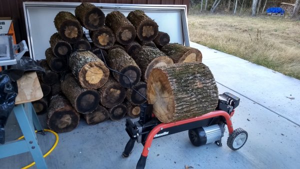

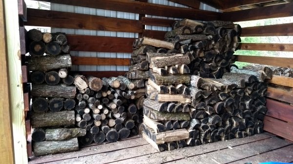

    I got everything done except one that's not too bad. By everything i mean what i put on the porch in the rain. Today was a lovely day.
    Here is what's done so far for the shed.
