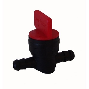

    You can install a cut off right into the fuel line yourself.$2-$3 bucks at most.
    I just did it on a riding mower that I couldnt get to stop leaking past the seat and would hydraulic motor to keep it from starting.

    I have installed both a cutoff (as above) AND a drain port on all my small motors. So now when I am done using them if I will use it within 1 month, I will just shut off the cutoff and let the motor run dry. If I will not use it for over 1 month, I run the motor dry with the cutoff valve, and then drain the entire fuel tank dry. To do this, simply install a "T" in the hose line a few inches after the fuel tank, on one side of the T install the cutoff and continue on to carb with the old hose. On the other side of the T, install another cutoff and a short piece (6" or so) of hose with nothing on the end. Leave this cutoff closed always, except to drain the tank.
    I've done this to my generator, tractor, snow blower, gas hedger, weedwacker, 5hp outboard dinghy motor.... haven't had any problems since!
