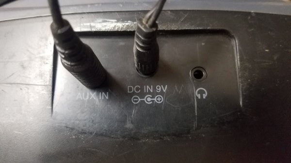

    Should be printed on the camera itself like this. Notice the positive sign here pointing to the center post. Lucy
    Btw, what model camera are we talking about? I may be able to dig one up for you.
