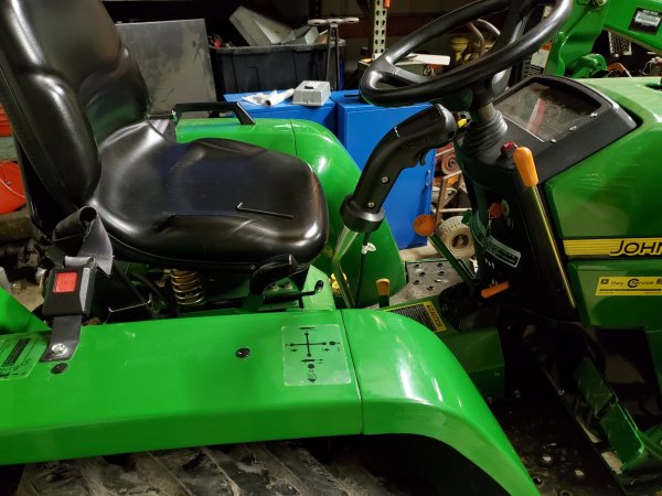

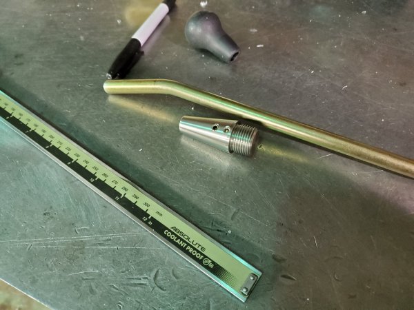

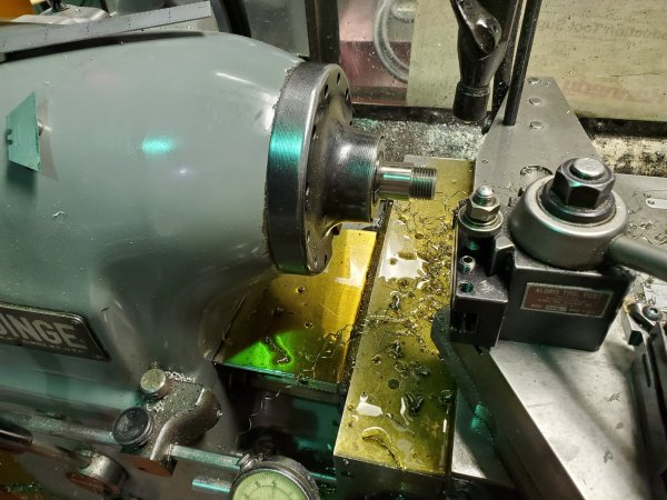

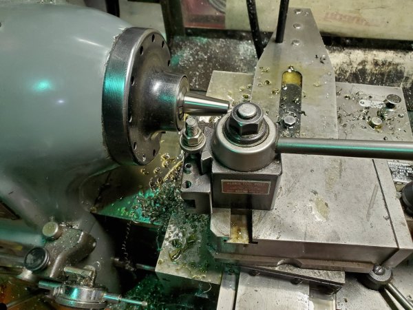

    I thought I might post my adding 3rd function to my tractor. If there's interest. 20200104_151648.jpg This is what I'm starting with 20200104_161332.jpg The control handle is 7/8"14 20200104_171920.jpg The joystick handle is 12mm 20200104_172132.jpg

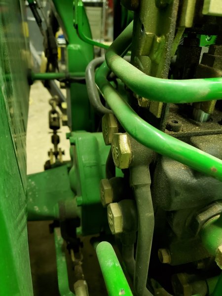

    I still have the rest of it to do but at least I got started. Trying to make my mind up on how/where I'm going to mount the valve.

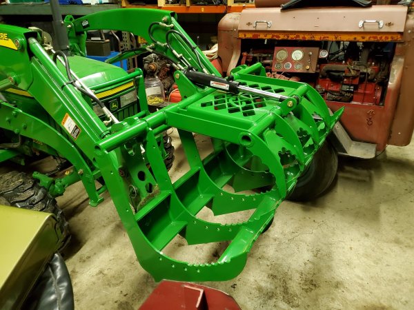

    Nice work, show more photos of the tractor and what the 3rd function is going to be used for when complete.

    20200102_181504.jpg This is the main reason for the install.

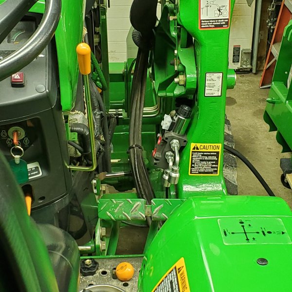

    Tried to put the valve between the existing valve and the fender but it's just to tight. I have reluctantly decided to mount it on the loader tower. 20200116_202934.jpg
    Started flaring and bending the lines that mount on the loader.

    You’re gonna love it. I had mine added by the dealer when I bought my tractor new. It’s mounted on the joystick that operates the loader controls. It’s an electric toggle switch. Asides from the grapple, it’s also really nice for angling a snowplow. I’d like to add a rear remote to my other tractor to operate a hydraulic dump cart.

    I'm looking forward to the angling of the snowplow. Now I disconnect my curl cylinders, kinda a pita.

    Saw a electric grapple for sub compacts today. Made by worksaver $1975.00 due out mid February.

    Had a little bit of time so I got the valve mounted.

    I just looked it up, pretty cool. Nice and lightweight also.

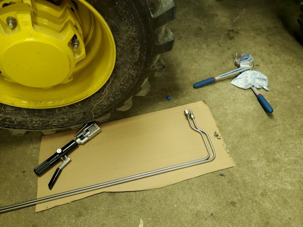

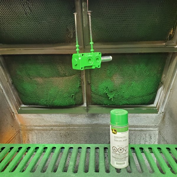

    Finished bending and flaring the stainless lines today. 20200119_204359.jpg Couldn't resist painting the valve.
