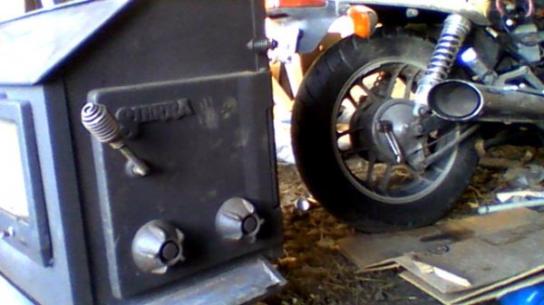

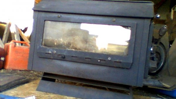

    Have had this stove laying around for 15ish years, probably was bought used at that time. Was wondering if anyone knew much about them? I was thinking as others suggested a welded in baffle would be well placed, then also a pipe baffle. Any thoughts, experience, etc would be appreciated.

    I've heard of them and only seen one in an antique shop, "working" . Pretty neat! Putting a baffle in wouldn't take much at all. I wouldn't baffle the pipe, to much restriction. There were "MANY" off shoots of the Fisher when they hit the market, that stove I believe is one of those. With a little research I'm sure you can find lots about it. :)...

    Thanks Weldrdave. It certainly resembles the Fisher, I put a baffle on the pipe and it was too much, needed to run fairly wide open. I did a Google search the other night but not much success. I'll continue on. Although the first night I did have hot coals 7.5 hrs later...

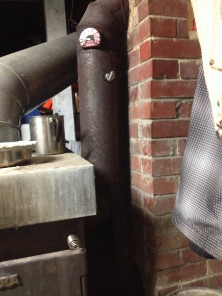

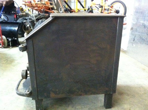

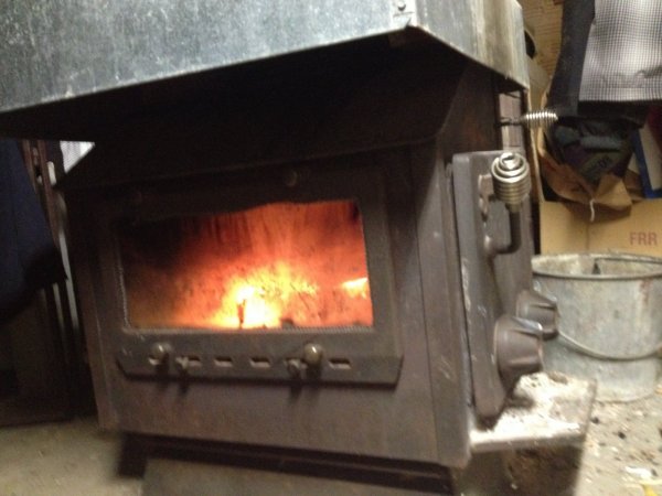

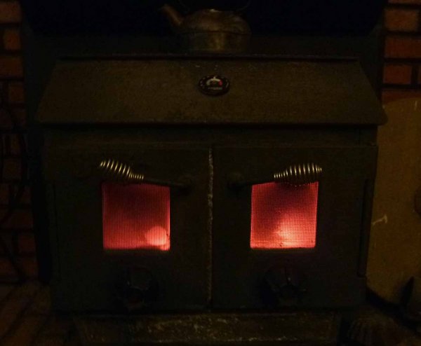

    Here is a couple pics of my Sierra. I bought it used and can't remember model name. Mine has a baffle of sorts in it and I have a damper in the pipe. image.jpeg image.jpeg image.jpeg

    ^^ This one was in my family for decades. I burned it for ~12 years. Good solid stove.

    Nice pics fellows. my little Sierra really does crank out some heat. Thanks. If you get a chance when the stove is down would you mind to take a picture of the baffle of sorts? Thanks.

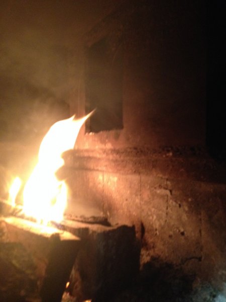

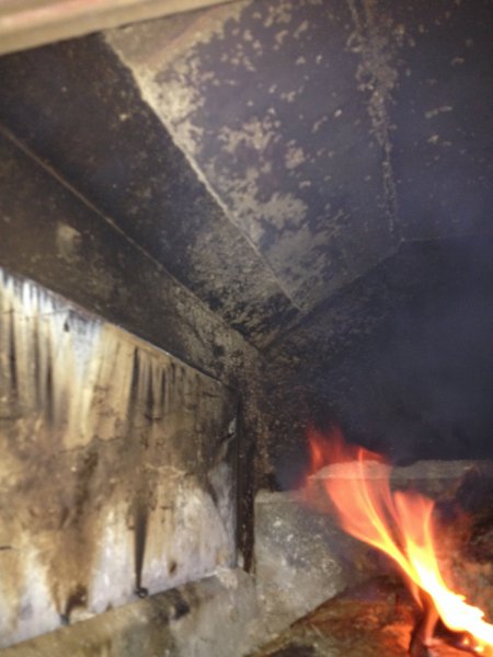

    Baffle is channel piece welded to angle and top piece that direct exhaust up and around then behind part where door is into pipe. image.jpeg

    My inlaws have that stove...it does make some heat, too bad a full 50% goes up the chimney.
    Did you make and add that? Looks a whole lot better than the "baffle" in the inlaws Sierra...
    Edit: Never mind, I just noticed the upper handle, I think you have the Classic Turbo Burn 2000T.
    I believe my IL have the older, more basic "campfire in a metal box" Hearthstone Classic

    Its all stock. I bought it used from CL about 10 years ago and cant remember model name. Ill have to check metal tag on back.

    Tag says T1000 built in 8/79.
