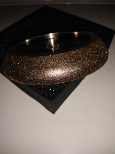

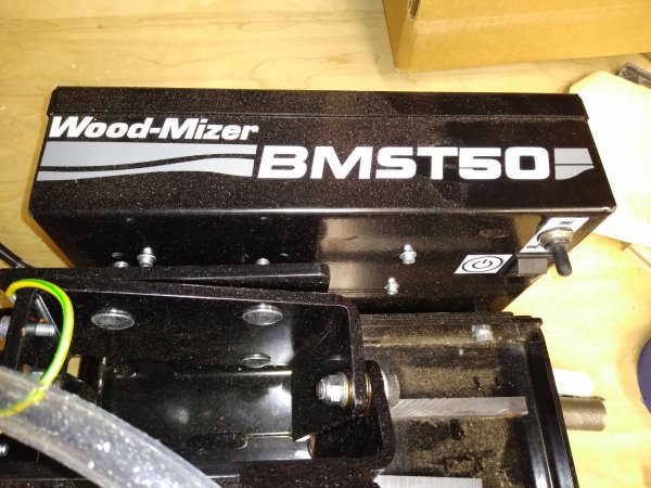

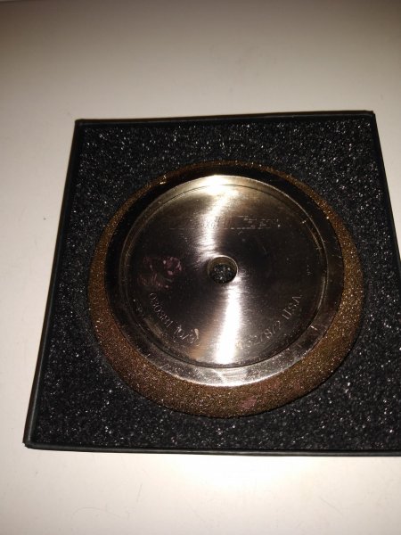

    Received this about 2 weeks ago. Some assembly required. All went well until I went to hook up the return line for the coolant and found that the coupler on the grinder is metric and the plumbing is sch. 40 npt. Woodmizer is working on a solution to fix the problem. Virus is slowing down shipping. Ordered a new wheel with a 10 deg. Hook angle and a 30 deg. Back angle. More pics to follow when I get it all out together.

    Update on build. Spent most of the day tinkering with the new grinder. Definitely a learning process.
    Owners manual doesn't say anything about nail hits. Took a picture of the manual.
    On the Internet there's videos of the grinder in operation and how to use it. They are pretty useful. Also the manual is available online, it's like 57-60 pages long. Hope this helps you decide.
