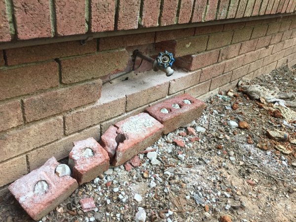

    Plus the spigot under the deck leaks and had no way to be removed.
    4" frost free faucets should be here this week
    Always need 6-8 things going on at once otherwise I'd be sane and sober. image.jpg

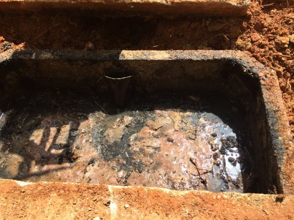

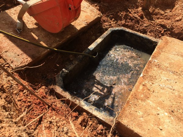

    IMG_1115.JPG IMG_1116.JPG Pumper guy couldn't make today so...
    Ran a hose test today after cleaning some gunk from the funnel. My suspicions are confirmed- NO Leach field :headbang:
    The outlet of the funnel over flow tee just goes into the formed opening in the tank, into which some pieces of asphalt have been jammed.
    The tank just filled up no draining.
