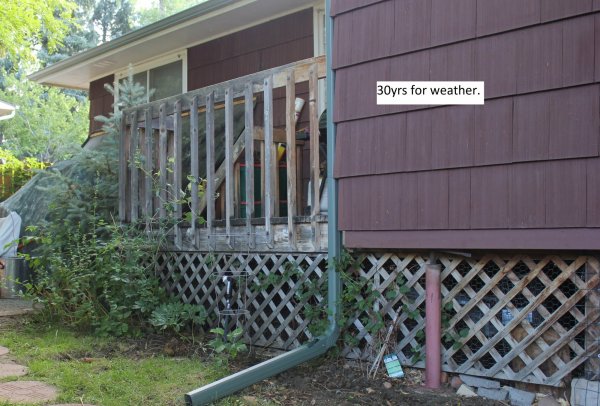

    Knocked out another rebuild/refurbish. This porch/deck has weathered the storms

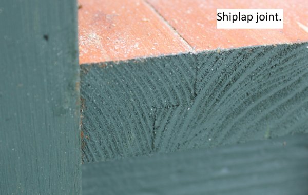

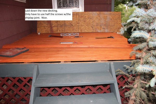

    for 30yrs. It was time. Sanded all the rails/posts down to new new wood. Installed
    new decking. Just used fir 2x6. Cut an opposing rabbet on the edges to create
    a shiplap joint. Caulked them as I put them together so the deck is water tight.
    That created a new storage area underneath. Nice. A little touch up paint and
    a "door" for the storage area and can move on to the next project.
