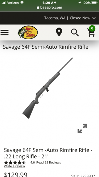

    Ok down to business. As of right now I own 4, a 12 gauge, a .22 plinker rifle, and 9mm and a 45 ACP handgun. Not looking to trick these out to the max but let’s start with the rifle. It is a Savage 64F.

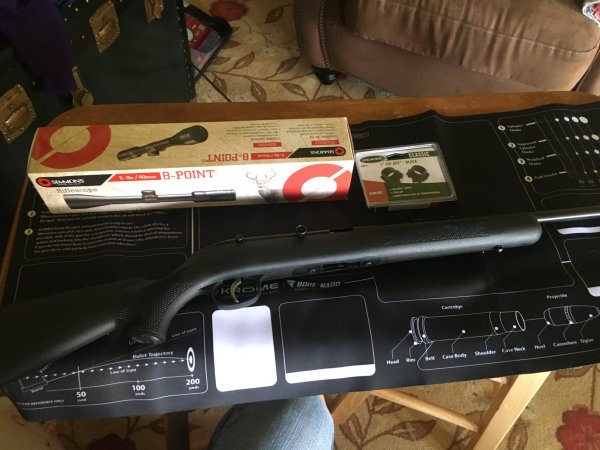

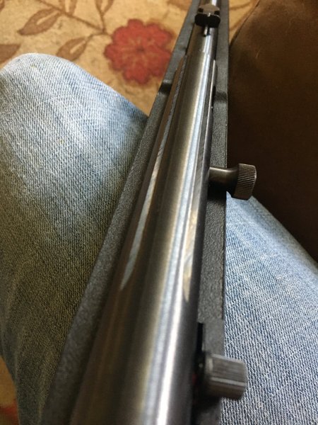

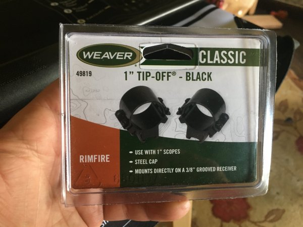

    Alright. And I suppose this is usual but no directions come with these mounts. Question is, did I buy the right ones?
