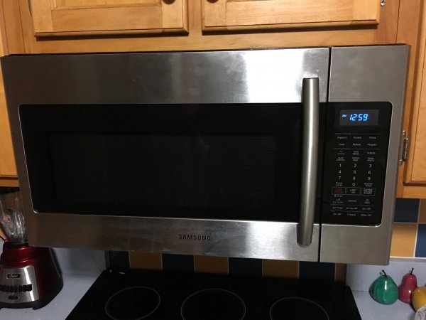

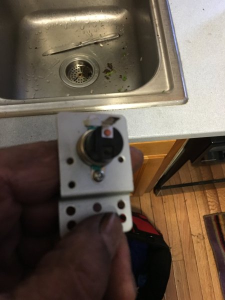

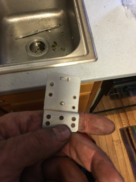

We only had this microwave for 4 months! The other day the Microwave ran for ten seconds then stopped and all the lights on the control panel went out. Searching the Internet for a similar issue said it was a bad control panel! However that is NOT the case! These microwaves have the cheap non ceramic mini high limit switches that can easily pop! Just like the hi limit thermo disc in a pellet stove that is inline with the AC juice to the auger motor! At least the pellet stove hi limit discs usually have a red button to reset them or in the case of Travis stoves they automatically reset. This microwave limit switch is a normally closed switch that opens at approx 190 degrees. There is no reset button and they do NOT reset! So if it dies and opens up then no AC to the control panel and microwave does not work! After installing a new switch it is working again. See pics Pic 1 - Microwave working again! Pic 2-3 Thermo disc mounted on a metal heat sink type bracket.
