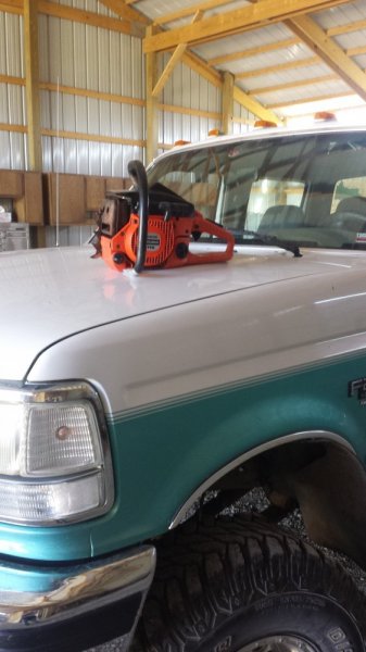

    We we're cleaning out an old shed on the farm full of 40 year old junk. My father in law opens an old drawer and finds a Dolmar 116. I put a little gas in, started 4th pull. Needs bar and clutch cover, filter, plug and tlc. But it appears to be in good condition with good compression. Anyone know much about them?
    Finding another good saw is like striking gold. He's owned the farm for 17-18 years, old owner left it behind.

    Those are VERY nice saws, put the time, TLC and $ into it. You will not be sorry! You will get a taste of what the older designs are about compared to todays' iron.

    Very nice saw. And it stated !! A little simple green and elbow grease and that saw will shine. Congrats and good luck :)

    Thanks guys, it seems like a very well built saw. I have 50 & 70cc saws so this will be nice addition. Have to find handguard/ brake clutch cover though.

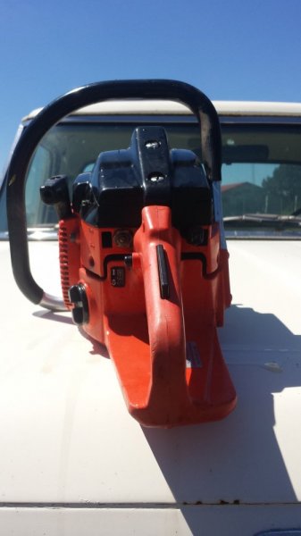

    Cleaned it up a bit today. I just ordered a hand guard clutch cover for a 120, new piston, and bar for it from chainsawr.com.
    Still looking for air filter, any ideas? Would like to adapt it to some newer style. Doesn't look to easy on this saw though.
    My 8yr old son came out to look at it and it started with one pull, after not touching it since the other day when we found it. Sorry I got carried away with pics, just cant believe we found this in shop full of old farm junk. The tag says 1987.

    I'm dying to run it myself. It seems like such a well made saw. Sounds good too, kind of deep. No piston needed either, ran it for a bit and it cleaned right up. Starts first pull, first pull! I don't own anything that starts like that. Parts can't get here fast enough.

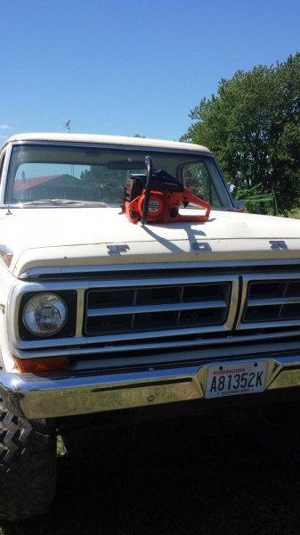

    Is there no air filter at all? You can always use the filter material used in the typical forced air heat setups if you have something to mount it on, in a pinch until you find a better solution.
    Nice saw.... But I'd like to see more of the old Fords!

    Saw looks great, I too want to see more Fords! And the barn looks great! There is a guy out there who makes custom filters for saws that are NLA, he made me one for a Pioneer P-40 I restored for a friend, I'll try to find him for you.

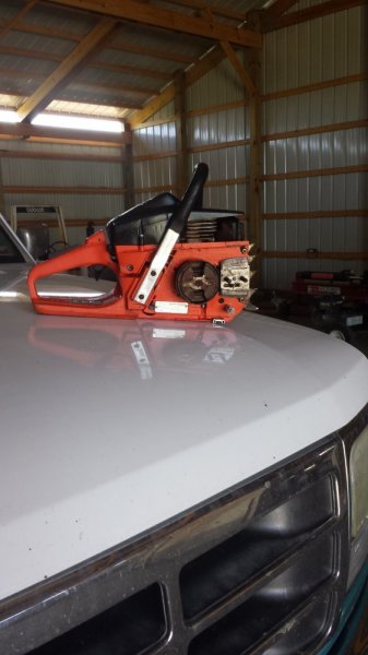

    It has an air filter, just real dirty. I took dish soap , warm water, and tooth brush to it. It cleaned up nice. Might be able to take a razor blade and remove old nylon material. Then epoxy or superglue new filter material into frame of filter. The hole in the cover that feeds carb is round. If it wasn't so nice I'd cut it and do a velocity stack out of the top. Just can't bring myself to do it. It's good for now. I'm just lucky they ran it out of fuel all those years ago.

    Parts came in from chainsawr.com. Is he a member on here? Anyway, the clutch cover hand guard assembly said it was for a 120. Just opened it and it still has a worn decal for 116. The 20" bar is a .325 x .050 78 links. So now I need to find a sprocket and chain. Sprockets What I'm not sure about. Anyone know if Husq or Jonsered would fit or are around?
