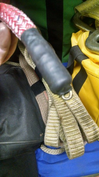

    I put the heat shrink rope ends from McMaster Carr on mine, has a heat activated adhesive inside. however I still sewed it up first as old habits die hard as they say.

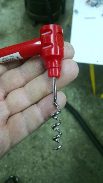

    Here's a pic of mine with one of the eyes I make from wine corkscrews to attach my throwing line . IMG_20180204_174341771_HDR.jpg IMG_20180204_174500509.jpg
