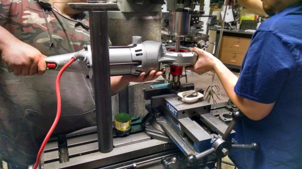

    Play the banjo music. Rush job tapping 175 1 1/2" NPT steel flanges. The ridgid 700 is driving the tap, pipe takes the torque and the bridgeport is aligning and down force. Delivered all flanges 3 1/4 hours after first hearing of the job. Total teamwork, I'm proud of them.
    We never tried this before.

    I know a machinist or two that would consider using a Bridgeport in that fashion abuse.
    But that's something I would do in a heartbeat (when they weren't looking).

    Actually it is easier on the bridgeport.
    No torque or force's of any kind is being transferred through any of the moving parts of the bridgeport, including the ways and spindle. The quill, spindle in neutral, only guides the start and after that it is not even touching.

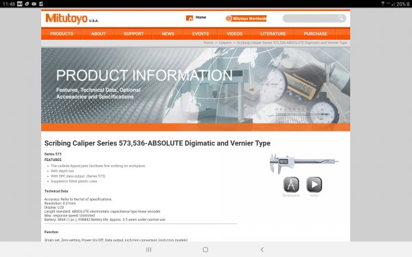

    Like using your 200 dollar Mitotoyo calipers to scribe a line on your part a certain distance from an edge. They don't show you this in class either ; why ?
    Because it works so well , who cares about the abuse on your equipment as long as you get the job done.
