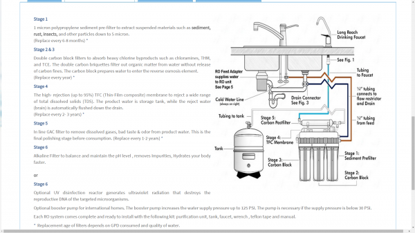

    This is the drinking water one. See the faucet? It's really the same setup as mine but it lacks the Deionization chamber. DI water is not good to drink, but great for fish. When I make drinking water, I just switch the valves on line so it doesn't do RODI, just RO. When I get enough drinking water, I flip it over to DI and fish tank water refilling.
    Mines a different model, but they are all nearly the same, just more or less filters, and attachments, as well as different cartridges.

    The dark blue line in the diagram, the waste line for this is 1/4", suppose I can use and additional 15' of 3/16" line before emptying into the our grey water drain? The line will not be under pressure, it will dump freely into the washing machine drain (grey water)

    Update, he ended up running the waste water line to our septic tank. Not our first choice.....it can be changed in the future if needed.

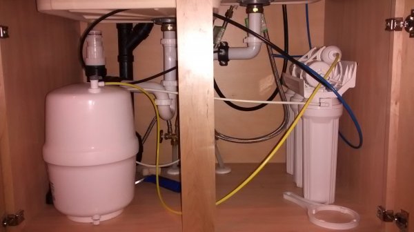

  19. TurboDiesel
    16,196
    97,190
    This "connection" needs to be a "safe waste" with "air gap"
    the filter drain pipe ends above the floor drain. (It could run into a laundry sink).
    so if the floor drain (or sink) were to back up it would not come into contact or back up into the filter drain.
    cus_deluxe, Stinny and wildwest like this.
  20. TurboDiesel
    16,196
    97,190
    I looked at the pic again. I see filter drain tied into the sink drain now. Thats good. (as long as the flow restrictor is there):yes:
