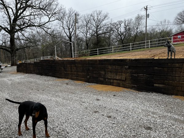

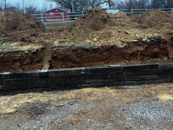

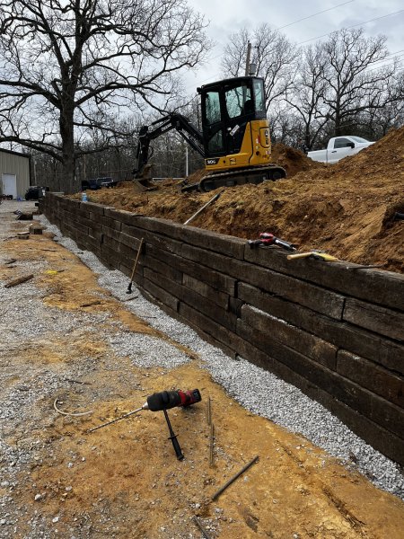

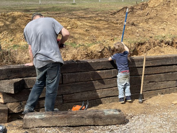

    Cut very little wood last winter , was rebuilding our retaining wall. It took me 4 months , a ton of blisters and many long days. Pleased with the results tho. Driving the rebar pins was hands down the hardest part. Each tie has 4 18” pins securing it to the one below it. I bought two 20” carbide tipped chains for the cutting of ties. $100.00 a pop but after going through all my resharpened loops it was a good investment. Got the ties cheap enough and had to buy a new right angle drill and SDS Max drill so we have about $4800.00 total in the wall including diesel for the equipment. Not bad considering cheapest quote to do it was 10k using our ties.

    Nice job, that is a lot of wall for 4800.00...You saved yourself a fortune doing it yourself!!

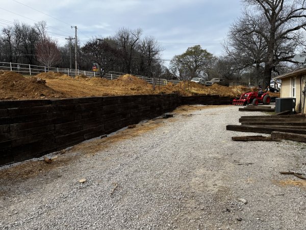

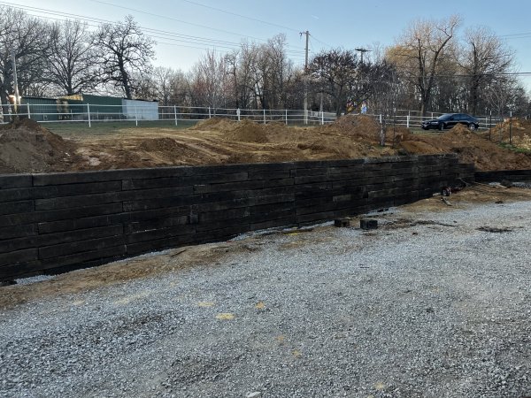

    Thanks ! Pictures don’t really do it justice. At the tallest it is almost 7’ tall. I sort of goofed and hit it with the tractor while backfilling and pushed it out. Added a deadhead at the top row so should be good but was almost a big mess up. I hope I never have to do another one ! I am not scared to work but that is a job for a younger feller for sure.

    That wall is huge! I can see why it took you so long. My sons and I built a railroad tie ret wall that was only 4 rows high and that was work enough. I can't imagine going 7' high and that length. It sure turned out well! Dog and kid approved, love it.

    OMG, I still remember installing RR tie retaining wall at my previous place. We were still in our early 40's and it was not easy. I think we used 24" rebar for each level, but maybe I'm misremembering. The Ex drilled most of the holes and I did most of the driving the rebar in. I think the highest we went was 3 ties, so not nearly as much work as you put in.

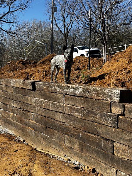

    Is that a pure Dobie?

    actually he is a Black and Tan Coonhound!
